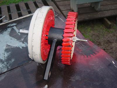

I'm making a dual F&P Wind Turbine as per this thread by Gizmoand. A note to Gizmo: "I'm following in your footsteps, don't know exactly what I'm doing but entrusting your good diagrams and instructions."
I bought two second hand 42 pole F&P (think it's .6 ml wiring), will get some photo's up of this as i go and this can end up being a long thread about it's construction, l'l get a YouTube video as well.

Bit hard to tell by comparing the photos by the real thing in the F&P series but i think I've got an 80 series.
Since fiddling around today i got the second stator decogged. Though they spin much easier i thought they would spin pretty much freely.
Wish my camera batteries didn't fail me today want to show a pic of the two F&P joined on the existing original spline. It's got the white slat like plastic which came with the second hand F&P that's been cut off in a square and slipped on the shaft it's got the four bolts that bolt the stator onto it with the bearings embedded in the white plastic.
I can't see why i could not bolt a horse shoe strap over the white plastic along the spline covering the them securing it to a metal plate mounting bracket and not have to do all the fancy welding to make the other mount.
The two F&P motors and apparatus fits nicely back to back onto the one original spline with nothing having to be adapted or done. And i think there might just be enough room to bolt a hub onto it.

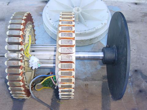

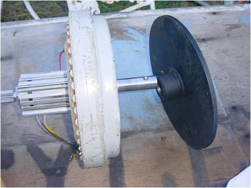

Posted: 09:52am 14 Dec 2010
Hi hope this might help I drilled out the plastic magnet hub and put a keyway in.
then just cut off one spline for the blade mount.
and my hub.
Edited by shawn 2010-12-15

Thanks for the photos Shawn i will have a good study of them. I'm a bit stalled on this now till i work out what to do and ive got to get the bloody things rewired to, wish i had of paid the $40 extra now it would have been worth it and a bit quicker.
shawn
Joined: 30/03/2010
Posts: 210
Posted: 06:34am 15 Dec 2010
I would not recomend welding any part of your shaft use what you have, cut it ok,extend spline not my way but also ok, but keep that welder away from it.
