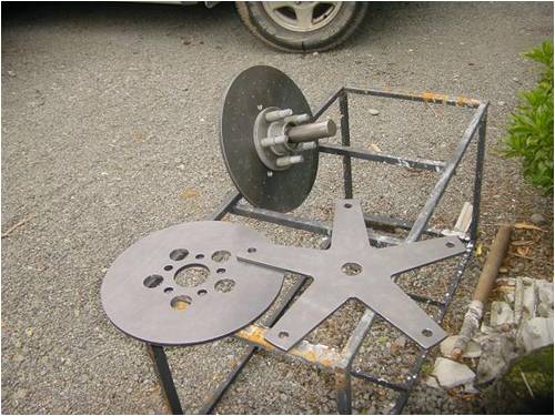

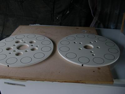

first some pictures of magnet plates 360 diameter 10mm thick all lazer cut these will have 50 mm diameter 15 mm thick n52 neos 12 per plate
these are at powder coaters now

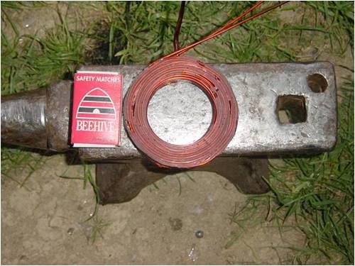

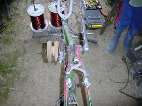

and my state of art fine tuned coil winder I did not put my sons boots on
and a finished coil 50mm hole in the middle

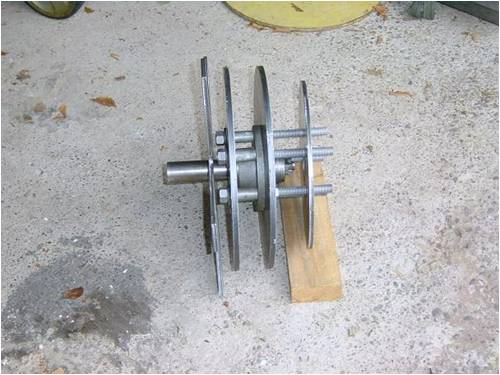

and trailer hub with 16mm tapped holes for althread

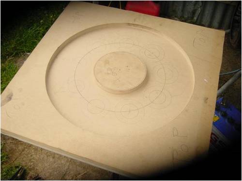

I have built the mold for the stattor and am not sure about round coils or egg shaped or slightly rectangle ???

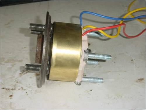

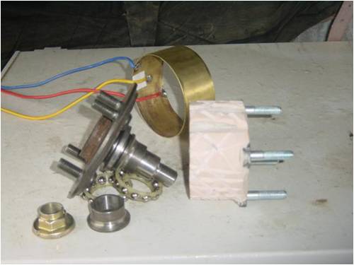

also have one of petes master pieces on the go sliprings built around car hub for mill to turn easy into the wind.
will post pictures as this progresses.

I like the coil winder very clever!!
Just wondering when your son will get his bike back
Coils look good to, any info on the wire size and number of turns.
How have you impregnated the coil with resin, wet wound, vacuum, or just dipped.
You do realize the slipring idea is pattented, and all royalitys will need to be paid, current rate of 1 cent per ring
Pete.

Hi guys first pete i will definitly do my slipring just a little diferent
so no can do on making you any coin!!

The wire size is 1.6mm two in hand 40 turns trick is not to lose count while son brushes resin on while talking constantly (6 year olds always talk)

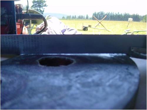

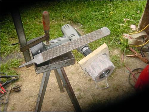

If you like my coil winder you will love my lathe here i am lathing some car bog i built up hub for rings.
after its built up enough i will put on ring and use it as a dam to full with resin
then cut the rings maby on my lathe.
and here is my mold for the stator stator will be 460 wide and 16mm thick.

Hmmm see you have one of those cheap Chinese lathes.
Now i have seen one of those wheel hubs before somewhere??
Had you considered using one of the hubs for your mill as they make a nice bolt in assembly, and i think the ball bearings are better than the roller taper bearings..
Pete.

I thought diferent bearings have been hammerd enough here... its all your fault pete you were just to slow with the post about these. They are great but mag plates are all cut out and powder coated now
shame cos i am going to make the offset from the tower adjustable and this bolt on type hub would have been great.

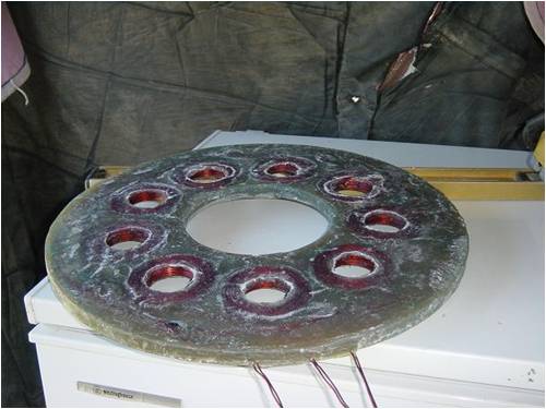

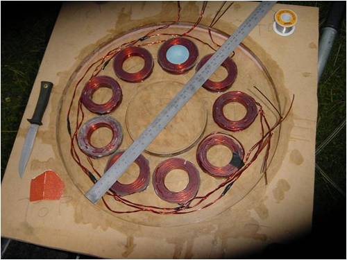

so time for some fun stuff here is my stattor almost ready to pour
The blue stuff inside one coil is wax I am thinking if I full them up
I could remove after leaving a hole this might help with cooling I read
this some where never heard how it went though.
kids love the wind too!!

Looking good.
One thing i notice is you have no glass in the stator, and i know others cast them without glass BUT resin has no strength without glass.
Put a sheet of glass under the coils and another on top.
If you can shove some more in between so much the better.
Glass (fiber that is, not broken beer bottles)will add mass strength compared to no glass.
Pour the stater in at least 2 x 1/2 layers,and allow each layer to set before the next, as a thick pour will result in mass heat in the resin and it will crack and buckle, even smoke if you have too much catalyst in the mix.
For polyester resin weigh the resin and use no more than 2% of catalyst by weight of resin. Thats 2Ml per every 100 grams of resin.
For a thick pour cut this in half (1%), the setting time will be longer but the temperture will be lower in the resin while curing.
The wax will work fine and i have used Plasticine (kids play dough)and even bluetac for a simular purpose.
Take all your wire connections close to one outer surface, so if you ever need to grind into the stator to access them it will be easier.
Still a little unhappy i dont receive the 1 cent per slipring for the design idea.
Pete.

yes have used fibreglass mat both sides, but you may be on to something with broken glass it is poor at insulating that is why you need to double glaze for the air gap
would it transfer heat better than resin? IT would not upset flux, might not be as strong ???
could be a cheap filler with the vinal ester i will use.
All comments welcome.

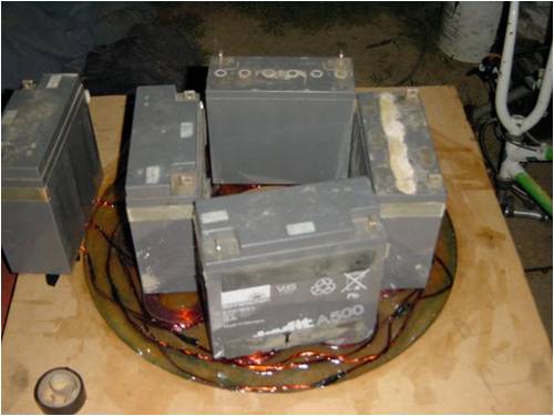

seems that trev and i are working on the same thing!!
Buy puting weight on coils until first beer can full of vinalester sets you
then can full with fibre before finishing you cannot see the mat in the
picture its finer woven than trevs stuff and you have to cut it.

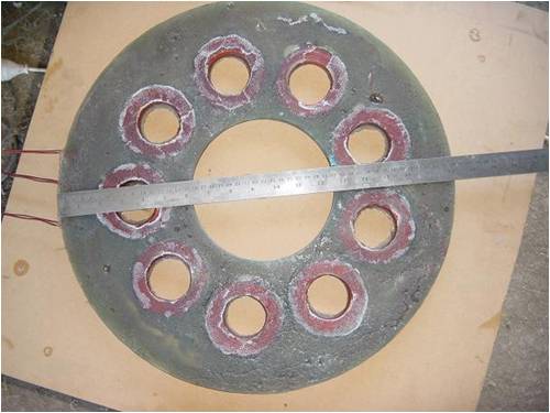

Ok stattor finished a few miny moon crators on the outside no bubles on the inside
but the stattor has a concave and convex side i mesured about 2 mm max when i put my steel rule across.
so not happy its my first one and i am sure its because i let it set on one side (half done) before finishing this must have twisted up before i finished.
never had much experence with fiberglass it shows a bit
I will put turbine together when i get my magnets and see what the gap is before deciding if i have to build a new one

Resin will take days/weeks to cure fully and you may have been a little to quick to demold it.
Buckling is often a cause of too thick of a resin layer where heat will build during the first stage of curing, the fact you waited for the first half to cure would not have been the cause, unless it was a thick layer.
Resin appears to self level but it dont very well, so it might just be not filled fully on the lower spots.
No reason you cant sand the outer edges down some to level it up.
If you find it is too buckled to use, then before you throw it away and start again, you could try placing it on a flat tray in a hot oven for a while, the resin will soften some, to allow you to place it on a flat surface with a flat plate ontop and apply weight to it and squash it out straight.
Try it first before taking the heating measure.
Pete.

you could check it a bit Shawn by just mounting and aligning the stator on the hub assembly
after you have it mounted attach a wire to the bearing hub extending it out to track the coils as it rotates (kind off like a record player)you can gradually bend the wire tip to float along the coils , this,l show up the trueness of the coils where the magnet path (the really important bit) will be ..as your using uber strength magnets you might have a little more leway with the airgap as well , this depends a lot on other factors though ...
ps...when your drilling out the stator holes dont do like i did and drill through a copper wire ,..double check everything if you can
pps ...looking back at the pics now i,m a bit worried about the wiring interfering with the stator mounts , its hard to tell ...hopefully theyl be ok Edited by niall1 2011-01-11
niall

Thanks niall and pete yes its not so bad as i first thought i guess with my ignorance i expected it to come out all pretty (not the case) it took some tidying up.
The coils are all inline with each other and the width of the mags is only 50 mm so across 50mm there will not be enough gap difference to worry about i will stick the mags on just leaving them protruding a little.
When i hold the stattor up to light i can see were the wires are so i will check this before drilling mount holes

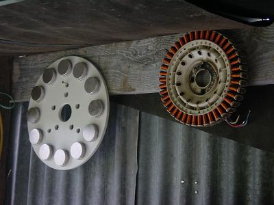

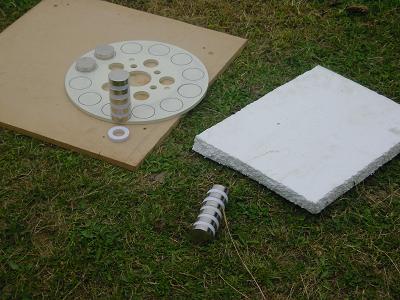

Hi guys the magnets arrived today (thanks bryan) and could not contain myself so away I went.
above are the powder coated plates I used a compass with a permanent marker to give me an idear were they should go!
notice the mark on the side, would be my luck that i put it all together and the plates repell each other.
I armwrestle horses for a living so am strong
these magnets don't have to ask for respect, they earn it quickly all buy themselves
up high away from the kids awaiting the stainless band and resin.
Guys this is my first build apart from f&p so all coments welcome!!
