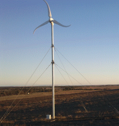

Thought I'd finally get around to posting some pics of one of my two mills..
This one is an F&P running as a 7phase 2pole rectification is done on the pole..
the blades are 1.5m PVC (Jabar's ones) that i got ages ago from him.. and they seem to work really well.. the tail is an old road sign that i found..
we've had this mill run up to 8amps and never had an issue..
Yes i know.. there is no furling on this mill, and honestly where we are located there is no reason to, as the wind isnt strong enough to enduce furling anyway!..
heres a couple of pics anyway to enjoy..
Steve
Posted: 06:03am 26 Dec 2010
Nice looking windmill there Steve.
Not having any furling is kind of scary. Furling has been a hot topic recently as these blades tend to behave a little differently than expected under furling conditions. So even if you did have furling, its not guarenteed to help. Maybe a mechanical brake? Its low enough to throw a rope over anyway, I do that to mine if I'm expecting strong winds.
Whats the system voltage?

Posted: 02:51am 27 Dec 2010
Yeah ive been reading all the furling topics for a long time.. my experiences with furling in lower winds though is that once furled it is very difficult to get them to 'unfurl'..
the mill above is on a 15m tower, and is running into 24v batt bank..
We've been thinking about a bicycle disc brake and caliper for braking, as they are very light.. but today its been averaging 2amps all day....peaking to 7amps.. the other mill i have is one of the original chinese 200w ones with the whipper snipper string fibreglassed onto the blades.. today its been averaging about 1.5amps.. so with them both and the solar, the batt bank is full..

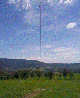

Re pt #2, You are talking about the windmill in the pic above? 15m tower?
Here is a pic of a 15m tower windmill [whisper200 1kW, 8'rotor], I have measured.
Here is a pic of a 10m tower windmill [Skystread 3.7, 2.5kW, 3.7m rotor], I have measured.
I have also put up a pic of a 19m tower.
My estimates put your blades at about 5m long. You may choose to confirm the dimensions. Good luck throwing a rope over a windmill up 15m to try and stop it.

I think you should get some protection mechanisms in place before you start to rely on the windmill power. Murphy will come along and wreck your windmill, usually when you don't have the protection systems in place.
If you are observing the windmill showing a reluctance to come out of furl, it suggests binding in the Yaw area, or problems with the furling angles.

yeh sorry.. i mistyped.. i didnt mean to say 15.. it is 5m..
Steve
Steve9R
Joined: 24/01/2006
Posts: 72
Posted: 08:45am 27 Dec 2010
we're planning on pulling the mill down next week, and will be adding the braking mechanism to it..
Steve
