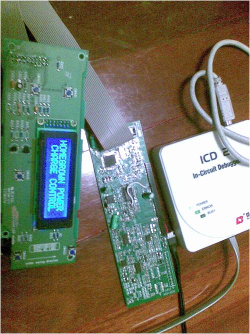

I'm currently developing a DIY Charge controller for wind turbine, below are some of the features that i'm planning to include in the first prototype. I will be building DIY PCB Kit as well for interested parties as soon as it's working properly.
Input voltage range without failure: 10VDC - 150VDC
Maximum Charge current: 100A ( Higher current for future kit)
Battery Voltage: User programmable thru 4 switches LCD user interface( 12V, 24V, 36V, 48V).
Charging control: 4 State Charging system
Display: 2X16 Blue LCD Display
Display Parameters: Input/Output Voltage, Charge Current/Power, Turbine RPM (voltage frequency detection), Charging mode, Fault Display, battery capacity.
Dump Load: 2 Channels, FET PWM Switching.
Fan Control: Temperature dependent
Protections: Overtemp, Short-Circuit, overvoltage.

Here's the Controller Design Block Diagram:
2011-01-08_192717_WIND_CHARGE_CONTROLLER.pdf

Posted: 12:11pm 08 Jan 2011
Hi Bob,
Yes it's a big project for this year, schematics and PCB design is 60% done, most of the effort will be in the firmware development and functional testing. I'm hoping to have the charge controller/Dump Load be ready for evaluation in 2 months.
