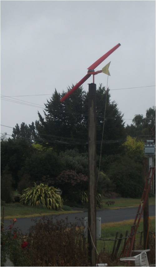

hi im new to this site and i whant to show my wind genorator i made out of
linex dc motor and some pvc pipe for the blades I get a good 14v in aprox 8km winds if not less as I dont have a Anemometer i live in nz
180V DC
1.5 AMP
POWER 200W
RPM 2100
ROTATION CW
FIFLD PM
you can buy the motor of trade me in new zeland for only 20$nz
I was wondering if its worth building another one of them or a smart drive one ? I allredy have 2 of these ones below

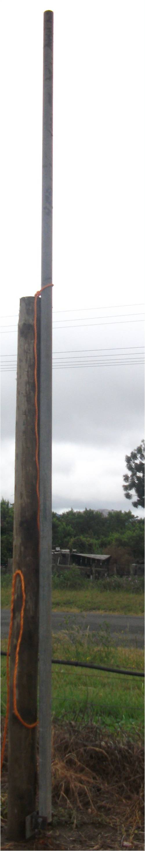

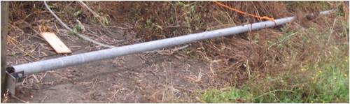

tilt up pole

thats pretty neat Fulfrog ....i can see from the second pics how the tilt up mast attaches to the pole....
nice machine as well ....
ps ...you might be able to run the cables straight down the steel pipe ,but this will depend on the yaw mount and how the mill behaves itself ....it does work well on a mill thats runs in clean air , so any twists in the cable will usually untwist....nature is a bit random like that ... Edited by niall1 2011-01-25
