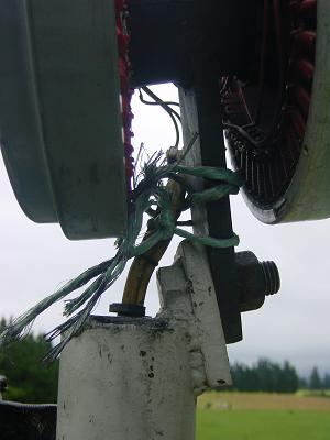

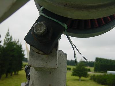

shawn
Joined: 30/03/2010
Posts: 210
Posted: 09:03am 19 Feb 2011
Im sure karls is a little diferent to mine as mine was built with what i had around (not a full workshop) but hope this helps.
As you can see just one nut to loosen and the mill falls down to the mast side icreasing mast mill distance, straight up and no distance, so you want to start straight out the side and work up as you get brave i did it this way cos i could have gotten the tail angles all wrong but with this setup its very forgiving.
and the string holds the wires away from the spinning mill.
edit Buy the way if you get the blades right you should hardly here it turning in the wind unless its a gale!!
And unless my amp guage is calibrated wrong i bought it from ecoinervation top my mill can do is a kw very respectable.Edited by shawn 2011-02-21

Joined: 29/10/2010
Posts: 301
Posted: 01:03pm 20 Feb 2011
Hi Shawn,
Your description supported by pictures are a practical help to understanding how to start with a mill set up, then safely control adjustments until the "sweet" spot is located. Thanks! 1kw is a better output than I'm exspecting, but if I come close to that I"ll be rapt! I'm planning to buy blades from Philm, balancing them accurarely and keeping runout within 1mm is emphasized in other threads. By keeping to these parameters I probably won't hear the mill running then, I'll have fun watching it instead. Thanks again,

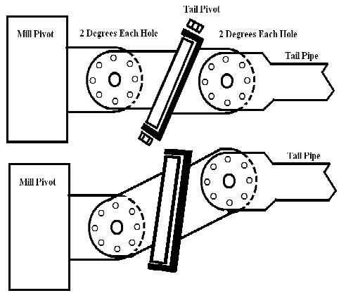

windman1000
Joined: 21/06/2009
Posts: 91
Posted: 05:48pm 20 Feb 2011
shawn
Your way looks easy but I would be to afraid of it coming loose and slipping down then not furling as much then it comes more loose to where it finally falls off.
I was having problems with getting my mill to furl at the right wind speed, so i decided to make the tail angle adjustable, I don't Have a good picture but here is a drawing.

Rastus
Joined: 29/10/2010
Posts: 301
Posted: 02:35pm 21 Feb 2011
Hi windman 1000,
Another viable option! If the head isn't adjustable, include it in the tail. While it was a passing thought to me, you've obviously made it work. Well done! I can follow diagrams/pictures to some exstent, thankyou, some of the practicle aspects aren't always obvious to me I've found. You have illustrated the need for 2 pivot points along with small adjustments by degrees. A number of mills are running similar setups to Shawns reliably, so it may depend on how big a spanner and brute force is used on the nut!

Joined: 30/03/2010
Posts: 210
Posted: 04:36am 22 Feb 2011
windman your way would be great I guess there are many ways to skin a cat! I have very high wind here and the tail gets a beating so in my case i would not have to many joins there.
the bolt/nut that holds my mill head is bigger than the nut on my car toball so i can swing hard on a big spanner to tighten, was going to add a stop if it got loose so it would stop half way down giving max furling but have never needed it so i never added it.
Its great how almost all mills are different but the basics are the same with the good mills anyhow, posting photos of your mill will always open the door for critasisam and i have given my share, but its the way i learn best so i give back what i have learned from others.
