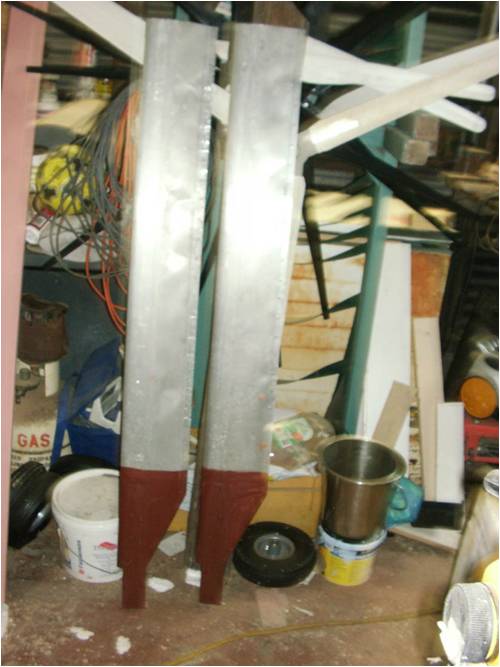

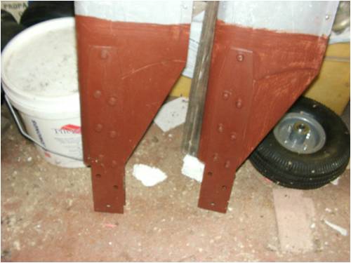

I am using a set of old gyroplane rotor blades that I inherited from the gyro school we had here many years ago, they had a ground strike so couldn't be used on the plane any more. I cut them down to 4 meters diameter and am aiming for a furling speed of 350 rpm in 15 ms wind.
Blade attachment plates.
The blades are very robust and are designed to lift 500kg in the original configuration, so will have plenty of momentum.

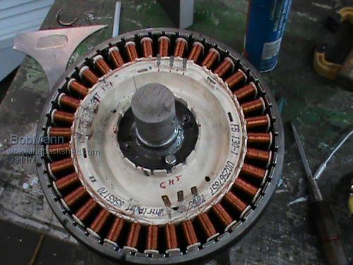

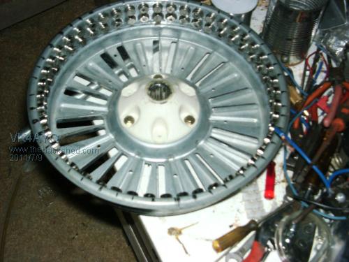

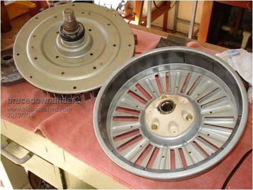

A pic of the stripped rotor .
I usually use those wall tile spacers (bathroom,etc) to evenly space the magnets while attaching them to the roughed up surface of the steel. then , cover the inside surface of the magnets with cloth re-inforced gaffa tape. Then mix the polyester resin and gently pour the spaces between the magnets with the resin ,OH, remove the tile spacers first,lol.
Have fun,,, Bruce

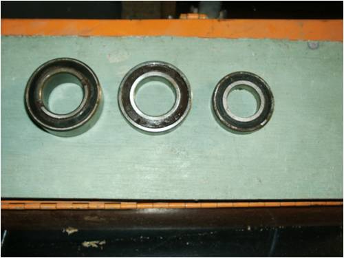

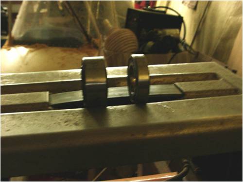

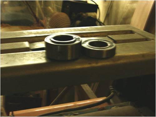

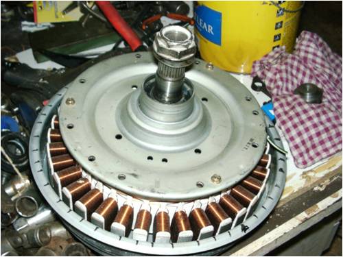

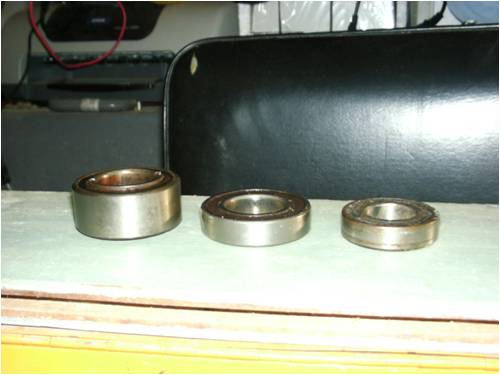

I have fitted a larger bearing in the front of the motor, this is a bit of a safety precaution due to the heavy blade that I am using, the blades weighs 18 KG when assembled so there will be a lot of force on the front bearing when furling.
The bearing on the left is the double race bearing, the one on the right is the original single race from the motor.
You can see the extra width of the bearing, it is 10 mm wider than the original bearing. This meant turning out the front housing bearing seat 10 mm deeper to accommodate it.
You can see how it comes right to the front of the housing in comparison to the original bearing.
This would be an overkill if using a lighter blade set, as a comparison of bearing sizes.
The bearing on the right hand side is the bearing from a Fisher and Pykel 100 series motor, the middle bearing is the original LG bearing and the left hand side one is the heavy duty twin race bearing I have fitted.
As you can see this makes the unit a lot stronger, so I hope it is worth the effort.
The turning out the housing was a bit of an effort as setting it up in the chuck and getting it running true was time consuming, then it had to be turned slowly as it wanted to ring like a bell from the tool cutting on such a thin section, sorry the photo of doing that didn't come out, due to my exceptional skills of a photographer.
I feel it was worth the effort though, but wouldn't recommend it unless you have a lathe or a verticel mill with a boring head.

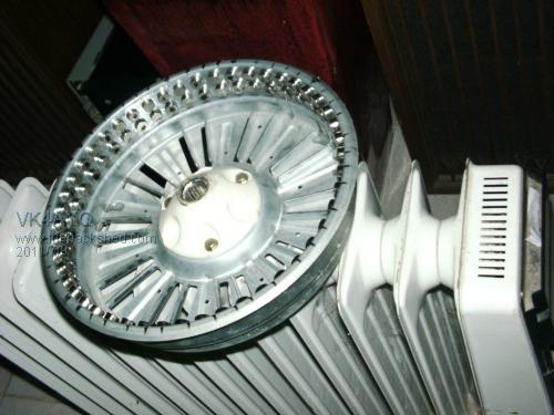

A lull in things to do outside caused by the cold weather and partly frozen hands has given me an incentive to look at LG again as it has been cluttering up my bench for a few months now.

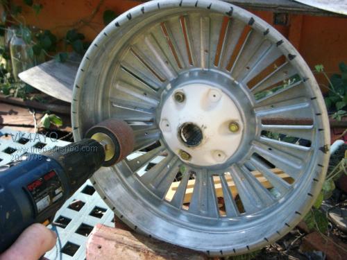

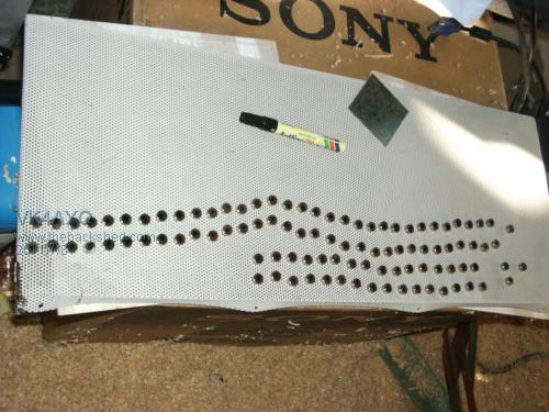

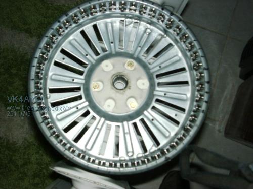

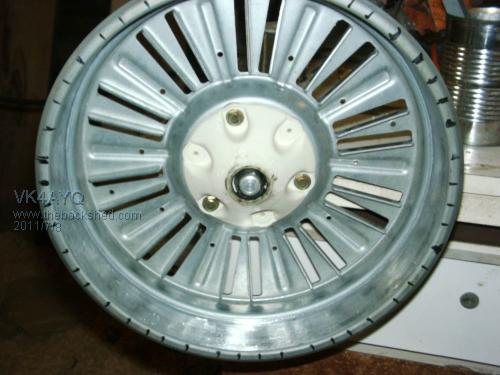

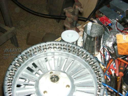

Today I decided to fit the Neo magnets to the rotor so a bit of a clean up of existing glue was in order.
The glue was quite tough and I actually had to scrape out the thicker bits as the little grinder wasn't coping.

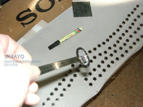

The next thing was to separate the neos, these little buggers have a mind of their own, they kept wanting to run to meet each other, to solve this problem I found a piece of perforated metal the back of an old power supply in fact, that way I could lay them out without running away on me.
The next thing was to polarize them and mark them, I used a little pole finder I got from frenergy magnets to get the poles sorted out in a controllable fashion.
They where all marked with a black marker pen to indicate the south pole, this little doover made it easy, and it works when they are close together as well.
The rotor was on an axle clamped to the work bench, not ideal cause it was a bit wobbly but it worked, I then gave the rotor a light coat of slow setting two pac epoxy to hold the magnets in place, the idea was good but they where inclined to slip around on the epoxy like it was oil, so plenty of sticky fingers resulted.
you will note that I have used round magnets on this with a bit of spacing and two magnets instead of three, this was because I read an article on magnetic saturation and how once that happens no further gain was to be had, so I did some testing on the original ceramic ferrite magnets and found one button neo was 5 times + stronger so I decided that two would be ten times stronger and should be enough. That's my story and I am sticking to it until proven otherwise by experts.
The magnets are 12 mm dia by 6 mm thick with a 6 KG attraction as compared to a piece of the ceramic ferrite magnet at 30 mm x 10 mm with less than 1 kg attraction.
There are 96 altogether two rows of 48 and it worked out at .250" spacing with the same between rows. I used a piece of wood to set the spacing's sanded down to .250"
It took most of the afternoon to place the magnets so lucky it was cold and the epoxy wasn't going off quick. They where inclined to slide around at the slightest bump, so in hindsight it would have been good to have a spacer for each set but once I started time didn't allow the luxury.
As you can see it worked out alright in the end but with sticky fingers.
Then I had this sticky goo on the rotor and the temp was heading for 0 deg C
so I adjourned to the house and put the oil heater on and sat it on top, now 4 hours later it has gone off, not a full set as yet but should be OK by tomorrow.
I will give the rotor a couple of coats of epoxy to reinforce the magnets and make up ad fitting device so it doesn't snap off the ends of my fingers assembling to the stator, the old magnets where nearly impossible to pull apart by hand so these could be much stronger.
The cost was over $100 for the magnets so i hope they make a difference to the efficiency, time will tell.

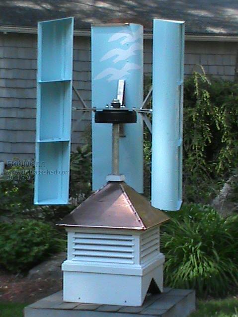

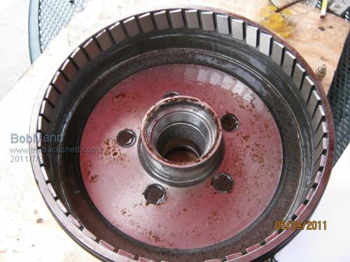

Hello I build a VAWT TREE TOP WIND MILL I build and sell a ready to go
Mann Smart Drive using the news 38 pole stator and neo magnets. I use a 3500 LB rated trailer drum and hub modified here at my shop.
If you wish I cam sell it ready to go for $400 US plus shipping.
All you will have to do is make up the plate to bolt your blades to and
the mount for the tail end of the axle shaft.
I have not tested on a HAWT I do not see any problem.
You are on the right track I have done a lot of testing on this.

Nice job on the brake drum I was looking at that solution myself but have too many projects on the go at the moment. I am not sure how your tree top mount will go as I found in the past that if things are not stable there is a lot of airflow interruptions on the blades, ours where however a lot higher speed blade than yours so only time time will tell.
Keep up the good work, and I liked the water tower situation just ideal for a big one.

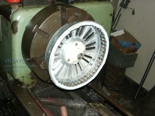

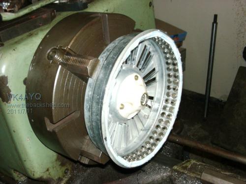

setting in the magnets in epoxy was a bit of a difficult contract as the epoxy kept creeping to the low side and would have put the rotor out of balance.
The solution I found was to spin the rotor and let centrifugal force even it out.
The strobe effect of the flash makes it look stationary, but it is turning at 100 rpm the epoxy is settling in evenly and about .5 mm thick.
I used double sided tape as a outer dam as all other tape where dissolved by the epoxy, so far so good it hasn't leaked out yet.
All the best
