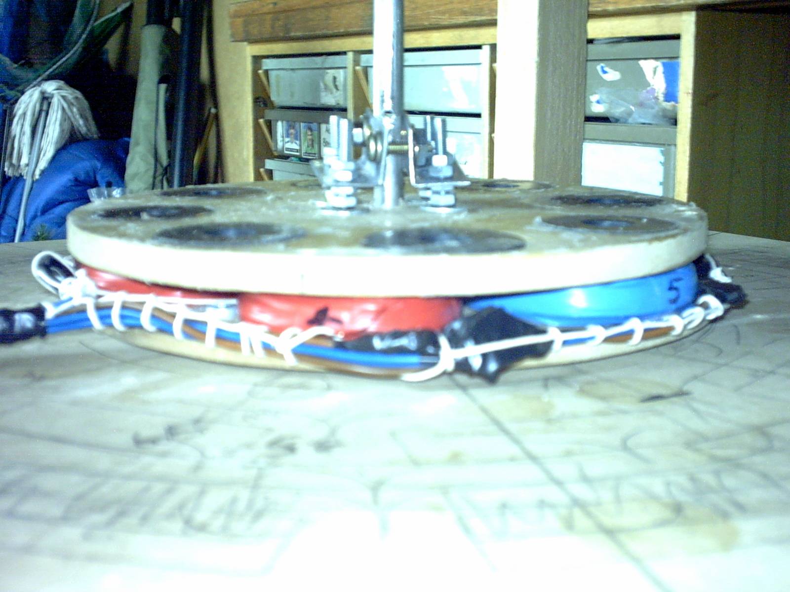

I AM IN NEED OF GUIDENCE!!!
Hi,
I hope you can help me. I am a complete novice when it comes to wind turbine design.

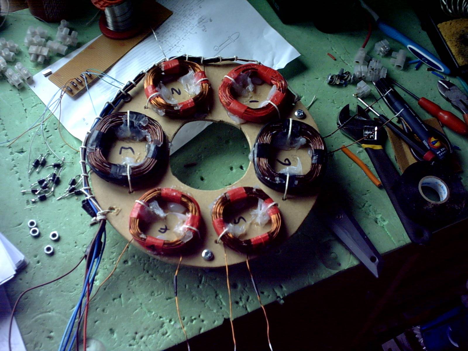

I have constructed a 15ft, including small oil drum cut in half vane, vertical generator. I
have made the coils, 6, from high voltage windings from microwaves. The 8 magnets came from
the microwave diode assembly, can't remmember correct name, are in a circular disc of 12mm
MDF board.
On nearly all the sites I have researched, they say generation starts around 7 miles an
hour. Mine needs some speed that can only be obtained using a cordless drill on high speed.
Nothing on the drill gives RPM.
The coils are air core. All I can obtain in a fair wind, 20mph, is 1.79Volts. They are wired
in star configuration. Tried delta. But that produces nothing.
Any ideas that do not use gear boxes would be much appreciated.
Thank you for taking the time to read my mail.
My best regards.
Raymond.
PS. A spare hurricane or tornado might do the trick. Edited by Solaray3232 2006-10-28

Have you tried measuring just one coil, see what sort of volts you get from one coil, you may have a wiring problem. Also how far away from the coils are the magnets. For the air core alternators you need to get the magnet pretty close.

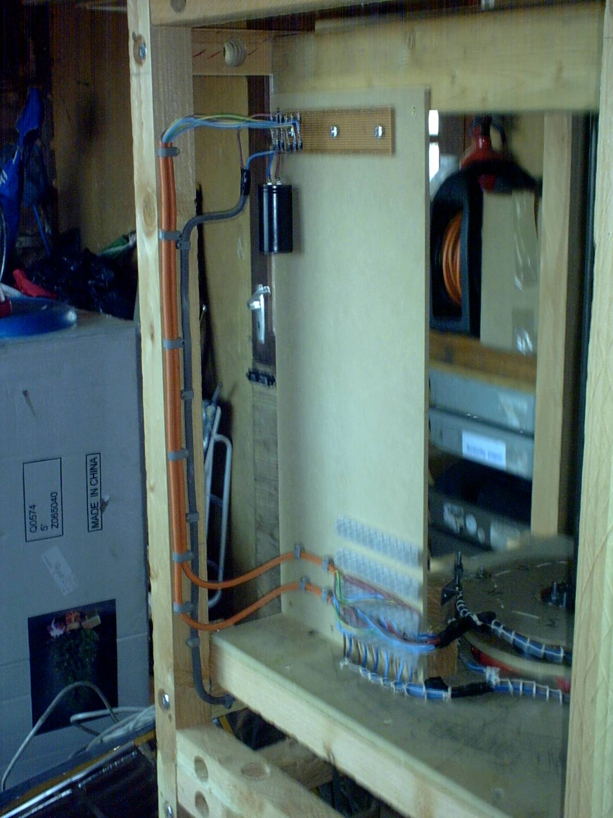

Posted: 11:33am 02 Nov 2006
Hi everyone,
I hope these pics got on site ok at your end.
Many many thanks again for all you help. Is there anyone in the UK who can tell me where I can get an abundance of microwaves. The shops round here give dud ones back to customer, because they have no room to store them. Surely there is someone sitting on a pile wondering what to do with them.
The reason I ask is I have been told I might do better with more coils and magnets. I have a 10 inch disc at the moment and want to go up to 20 inches. I do have the room for about 15 20 inch coil and magnet discs.

So lets review this design a little. You have your eight magnets in a disk with 6 stationery coils close to them and the magnet disk rotates? Is that basically the design?
The first thing that springs to mind is that there does not appear to be too much incentive for the magnetic lines of flux to pass through the magnet coils which they must do to generate any power.
If you can get more magnets like the ones you have I would suggest getting six of them and putting one under each coil. Now I dont pretend this is tbe optimum design but it is something you can try without undoing the work you have already done.
With this configuration when a like pole passes over the coil the lines of flux will repel so there wont be much flux passing through the coil at all, when a unlike pole passes over the lines of flux (at least some of them) will pass from one magnet to the other through the coil.
You could get a similar, maybe better (I dont really know) effect by mounting your coils on a steel plate. Better still by putting a steel plate behind your rotating magnets.
For testing purposes I would suggest isolating one coil from all others and putting your volt meter across that one, at least you will know when you have a configuration that actually generates then you can consider how you connect them together to get the required voltage.
I hope that helps as it must be quite frustrating to get as far as you have and not have any real output!

Raymond, I failed to mention it but I assume those magnets are mounted in alternative polarity?
Solaray3232
Joined: 27/10/2006
Posts: 5
Posted: 02:11pm 04 Nov 2006
Yes Kiwijohn they are. Many thanks to all for your continued help.
