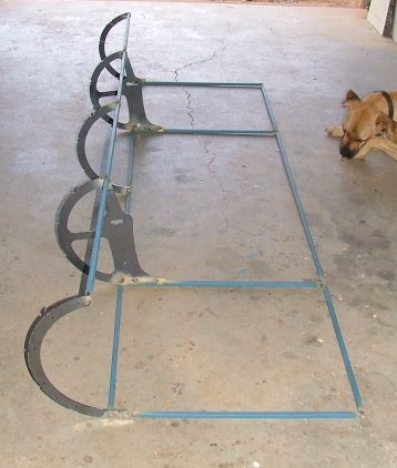

Hey I'm going to buy the sheets of aluminum for my lenz2 wings this weekend. The sheets, 2400 * 1200, will be pop riveted to this frame....
Now I have a choice of 1mm ( $50 per sheet ), 0.8mm ($40), or 0.6mm ($30). The 0.6mm is cheap, and I'll need 3 sheets, one for each wing. But I wonder what it will be like to bend around the nose, will it be too weak, etc. I really dont know as I've never used al sheet before.
Any suggestions of problems I may have?

Hiya Glenn,
            Eh mate 0.6 might be a bit too flimsy 0.8 I reckon would be better but also to help stop the al buckling between the bracing I'd be tempted to make some angle out of the off cuts and add a heap more bracing. Now looking at the picture it looks like your nose spacing is 600mm. Now what I'd do is install some angle around the radius to help strenghten the nose, put another cross brace at the centre nose prop then just put some angle across each setion in an X arrangement. By using al angle it shouldn't add too much weight but the extra anchor points will give the sheet better adhersion and shouldn't tend to buckle. The last thing you want is a bird flying ito it and leaving a nice nose impression in your new blades.
Just my thoughts
Cheers Bryan

hi gimzo
l have alot of experience in working on aluminum workplace like road fueltanker in the past so in my experience is 1.2 mm marine grade however i am not too sure about 1mm and would be better to get someone with plate roller to roll the nose that suit your lenz2 wing and it not worth to trying bending the sheet yourself or you be sorry just remmeber alot of road sign are 1,2mm or 2mm are use but never use thinner alloy will advaning crack up please use marine grade is Aluminium 5356 Tensile strength, MPa 240 or simlar as l do hope that l give the right information and l am building lenz with stainless steel is 1 mm

I expect the thin alloy would be strong enough and easier to wrap around the frame.
If your sheets are big enough I suggest bending a stiffening rib (say 20mm at 90 degrees) along the end that will be fitted to the edge at the top of your frame as it is lying on the floor. Once you start wrapping the sheet around the frame that is the place where I think the sheets will try to buckle.

Well I was going to buy sheets of 0.4mm colourbond. I figure it would be strong and cheap. But its not cheap, $30 per meter, so each wing would cost about $75.
I then did a search on Fieldlines for Ed's big Lenz. I dont know how he went with this, but he used 0.020inch aluminum sheet. Thats about 0.5mm. The story is Here. So I might buy 1 sheet of 0.6mm aluminum and see how it handles when I roll and pop rivit it onto the wing frame.

Posted: 02:37pm 05 Nov 2006
Hi Glenn,
The .020 works well.   I attatched the outer nose section first and simply rolled the frame around the sheet.   Works great!    Looking forward to seeing your new machine!
