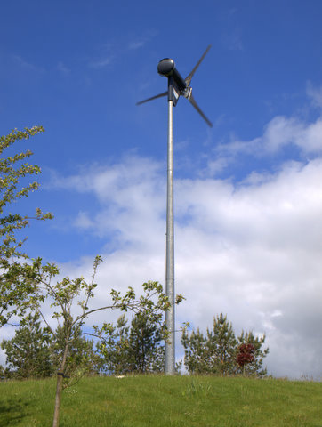

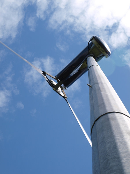

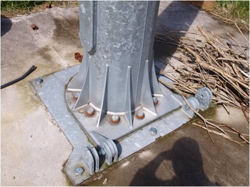

Anthony heres some pics of that proven machine ...nobody who knew specs about the machine
was at home at the time ..friendly people though ...
it (seems) to be the 5k machine , but it,s the first proven i,ve seen up close
so not sure about this
one thing very noticeable was how smooth the alt was at cut in...you could feel hardly any vibration in the pole , yet the alt was humming away
not much "helicoptering" from mast shadow either ...just sounded like a regular
upwind machine
i want one .....
pole does flex a little...shes a big girl

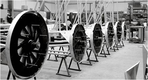

found this pic on the proven site....seems to show different combinations of
ferrite numbers on different alts
later edit...the one thing i really wanted to see was the coning/blade twist furling
method it uses ....not today though Edited by niall1 2011-05-13
