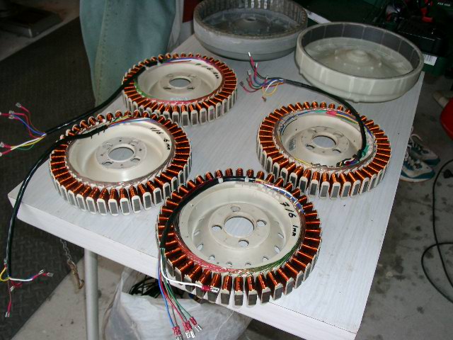

I've re-configured the windings on 4 stators of different wire sizes.- I'm interested in the 6 pole at this point of time as wind here is very slight. But one I configured to 7-2 pole in the .8 mm wire . It seems to be way down on volts compared to the 6 pole configurations.

My 7p2p conversion on 0.8mm wire is charging a 12v battery at a lower RPM than the old SP configures 0.6mm stator it replaced. Even though the 0.6mm stator has more turns per pole, the new 7p2p stator has a higher output voltage per rpm because the stator is not decoged, and 7 phase power has a higher output voltage than 3 phase.
Its working a treat, seams like its always going now where before it spent most of the day doing nothing. In fact I ordered a new 48 pole hub yesterday for the Lenz windmill, should be here middle of next week.
Have you tried one on your windmill yet. With your belt drive it will start a lot easier! You could even try that 3:1 ratio again.

OK, I must be missing something, but I dont understand how you can be increasing the number of phases unless you are also changing the number of poles on the rotor?
Posted: 05:22am 05 Nov 2006
Not changing the number of poles, changing the number of magnets. The old hub had 56 magnets, on the stator this meant a magnet and pole were lined up every 3 poles around the stator. The new hub has 48 magnets, and on the stator this means a magnet and pole line up every 7 poles around the stator. So we end up with 7 phase power. The result is smoother/less cogging rotation, and slightly more power. The down side is we need to rewire the stator into 7 phase.

Thanks Glenn, that makes sense even to me!
