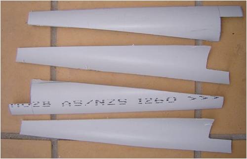

Thank you for the info and yes some very good info i will be out and about looking for a Fisher and Paykel so i can get started! I found some PVC blades on the web but they don't give all the info, the blades are cut from 100 mm SWV PVC pipe 500 mm long but the info doesn't say how wide at the tip and it also says to cut 50 mm out of the base but 50 mm by what ?? does anyone have more info on these blades because i have loads of the underground orange PVC which has a better wall which would be around 6 mm where the 100 mm SWV would be around 3.5 mm

Hi many have started with this type of blade they seem very comman I had 3 shots at them in the beginning fast to build and good startup but that is the only good points very slow speed hard to balance and any (real)wind and they turn inside out and break
If DIY is you I recomend oztules wooden blades my f&p flys them and they are great or the blades sold on this site also have terrific results and will way out perform any pipe type of blade (and live)
