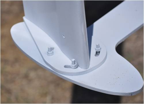

I have been encouraged to share some details on my Airblenda 500W VAWT.
VAWT's benefit over HAWT (your standard windmill style wind turbine) is that they work better in area's subject to turbulent wind conditions (in my case a built up urban environment). In these conditions HAWT's tend to spend most of the time trying to "search" for the best wind direction. I say this not from reading copious amounts of literature but by having a Air Breeze sitting up on my roof for 2 years.
I tied in the Air Breeze into my house electricity grid by using a SWEA (WWW.SWEA.NL) grid tie inverter, it worked well but spent most of its time trying to "find the wind" and then kicked out when the wind got > 12m/s, (which it does everytime the sea breeze kicks in). Yes I live in a windy area (Fremantle in Western Australia).
So I went about designing and building an Urban wind turbine that I could mount on my roof and which would generate around 500W in a 12 m/s wind, in turbulent conditions. But could handle winds greater than this and genrate more than 500W. It also needed to be smart enough to stop itself from being destroyed in a serious wind. Just to make it be useful it also had to be silent running, and not big enough to have the neighbours or govt types knocking on my door with a please explain.
End result is a 1.5m * 1m VAWT mounted on a 100mm diameter steel pole (with 5mm walls).
The following clip was made of the initial prototype in 5-7m/s winds
AIRBLENDA in action
Because its a prototype I built in a number of adjustment mechs to allow me to vary the angle of attack of the blade and other variables so I could easily figure out the optimal operating configuration prior to completing a more industrial strength grid tie unit that will mount on the side of my house and suppliment my grid tie solar unit. Lets face it I wanted a set and forget unit, not something that needed to be mothered all the time!
The unit is mounted on the outside wall of my house, in a normal suburban environment, and is on the wall adjacent to the bedroom. You would be hard pushed to hear the unit when its turning, and because of the way its mounted no vibrations are felt at all.
The blades for the VAWT I sourced from Phil on this website DIY Parts whilst I am using a Ginlong PMA, but a suitable configured F&P would also work quite well.
The Airblenda is designed to have interchangable Airfoils, PMA's, and also uses laser cut aluminium stays, all of which can be altered based on predominant wind speed, and desired characteristics and end purpose. i.e grid tie, or battery charge, low wind environments etc
Its been a decent learning curve for me but I am close to where I want to be at with my hobby in thebackshed.
The neighbours are happy, and also want one, I'm getting closer to supplimenting my electricity bill and my partner doesn't mind the time I have spent on it now that its out of the way and up on the roof :-)

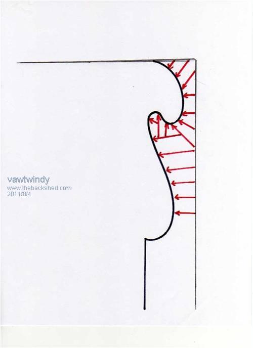

as you mentioned in youtube,
@Airblenda since it is swirling wind (is that a right term?) why can't you think of having small curves in place? like this
, by doing this will the torque shoot up? might be a difficult task, but i felt it might help you?
