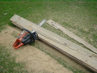

Hi guys has anybody else put resin over there wooden blades?
finished carving and sanding mine, and was thinking about paint when my tin of vinalester resin stuck out of the shelf so i thought why not i mixed it up then added a little thinner and painted them with it, it soaked in and set!!
took a while around a week for them to be able to sand without sticking up the sandpaper but when i repeated this this time with the spreygun the finnish was great and you can see the lovely woodgrain and laminations.
Has anyone else used this as protection for the wood? will it last??

any chance of another few pics of those big laminate props Shawn ....especially when you,ve assembled them and give us an idea of their size ....
what type of wood did you use for the laminates ?...
theres something about wood blades thats hard to get away from ...
chainsaws...mmm ....a lot of fun there i,ll bet ....Edited by niall1 2011-06-11

While I have not yet made wooden laminated blades for a windmill I made a few sailboat rudders in that fashion. I know, sailboat rudders don't rotate at high speed but they can be heavily loaded and need to be strong.
Looking at Shawn's pictures, there are a few things I would not have done...
Anyway, for laminating choose clear close grained wood, clear means *no* knots or cracks at all, close grained means around 10 growth rings per inch. Cut the wood from planks that are cross sawn - the grain goes across the thickness of the board. Diagonal grain is OK but then alternate your laminates so the grain runs alternating left/right as viewed from the end of the assembled blank.
Use a 2 part epoxy glue (with 'thickener', suitable for boat building) for laminating. Do not clamp too hard so all the glue squeezes out, epoxy is gap filling and a 1mm gap is OK as long as its completely filled with the thickened epoxy glue.
I would use an alternative laminate of American white ash and Douglas fir, there are of course many other suitable woods around. Criteria is they must be able to up take the glue (no oily or super dense woods) and not be too heavy.
If you are interested to make your own laminated windmill blades perhaps searching on laminated wooden rudder blades will hive you many hits on Google regarding the technique, the process is really the same.

Hi nail yes lots of fun I do enjoy making blades and can do it quite fast now wood is by far the cheapest way to go no question! and will give years of great performance.
I will post more pics soon and i have a few shots of the mill head assembly to with my sliprings.
Thanks tinker your advice is good I guess I just thought I could improve a little on my last set they were full of knots in all the wrong places made out of cheap pine , funny thing is I built them up with very little care and no laminating they have withstood 140km gale gusts even when they were out of balance this adds huge stress to them but still fine and spinning away.
These blades have just been cut with a table saw then glued together with gorilla glue cheap old pine again and plenty of knots ooooh well we will see how they stand up soon enough
Just a quick edit the new blades do have a very good profile this with a well matched Alt is were all the power is made.Edited by shawn 2011-06-12
