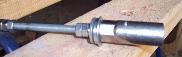

The output was measured with a 900 watt ryobi drill in 1st gear connected to a 16mm spark plug socket via bolted on all thread It appeared to be around 400-500rpm.

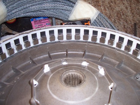

Hi Guys, those measurements are pretty high. I was winding the string around the rim of the magnet rotor, were you winding it on the plastic locking nut in the centre?

Hi highlander, It shouldn't be a problem, each staggered magnet pole is only widening the field a bit for each pole. the efficiency may drop because of the lack of magnet material missing from top and bottom magnets, but it should be a good guide regarding cogging.
re the water experiment. I was thinking my results were a bit extreme compared to yours.. so here are the figures. my rotor is 270 mm outside diametre with the string around the outside diametre, not the centre cog.

Re water test the F&P rotor is about the same size as your brake drum, but don't forget that your magnets are twice as big as mine. So if you double my neo measurement of 720 mm to 1440ml that's 230ml difference.
How freely do your bearings spin? And how accurately did you install the magnets? They need to be spot on so I'm told.

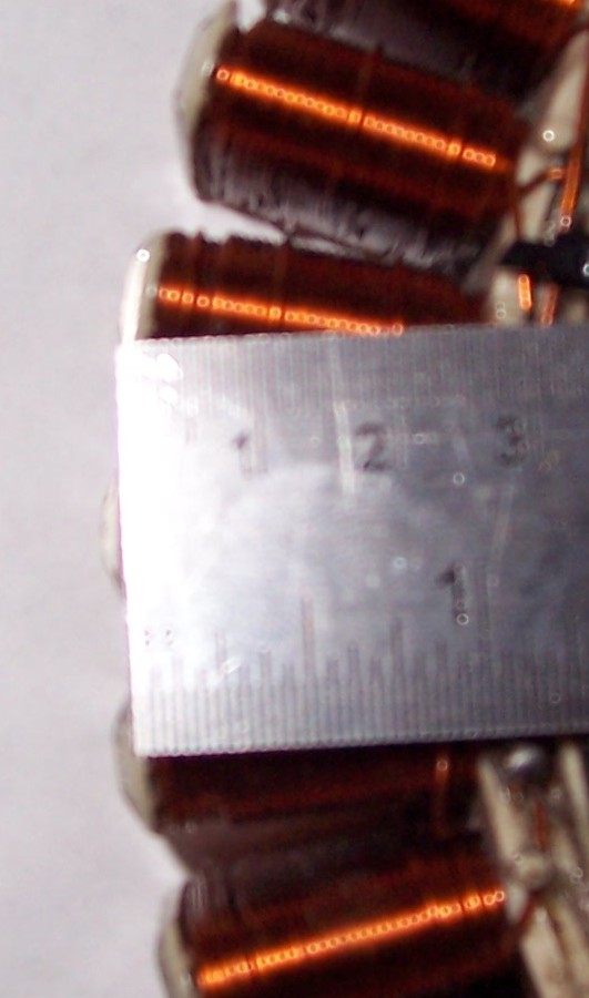

Hey Megawatt, I think I know what your saying is my drawing close?
here's a close up of the stator 90 deg to drawing
the second pic's a bit blurry like my vision on a saturday night
The metal protrudes only 1mm from the plastic former, the plastic could be filed back but the windings are only 2mm away.
Looks like a great idea but jeeeeeeeezzz a lot of work, with very precise tools req'd.
Well beyond my skills and farm tools.
I appreciate the reply though.

Yes, Highlander, that's what I'm talking about. You see, cogging is just an indicator that a very good magnetic coupling is taking place. And this means more power output, if you can only get the machine started against the cogging forces. Now the arrangement I am suggesting will not reduce the magnetic coupling effect, but there will be some rotation where the cogging effect is somewhat smoothed because of the skewing.
I am working on Dr Chalka's paper and as I see it, most people on this site are interested in more power, not less. Neverheless, what the Doctor says is correct and we only need to apply his arguments in reverse, to achieve more power out, not less. My immedate gut feel to the concept of reducing the number of active poles is - why not just make two windings of those already there and have two alternators operating on the same shaft but in parallel? And yes, it is a big ask to make all those pole pieces, that's why I directed my question to Gizmo, who has expertise and experience in laser cutting. In the end, my suggestion would need a production line process to make dozens of bits that could just be driven on and probably welded. A bit more about cogging with F&Ps. They are a stepper motor, and when used in position contol applications, stepper motors just cog! You change polarity of all the poes and the magnets in the rotor cause it to step to the next position in which the electro magnets of the stator match the permanent magnets of the rotor. It steps in fixed increments - cogging is it's middle name. And F&P engineers have spent many hours of calculation, design and experimentation to bring about a motor that is the best compromise they can create beween efficiency, power, cost, noise and no doubt, durability. So for me, who wants about 1 kW clear from these devices, I reckon I just have to put up with cogging. I further reckon that my other gut feelings that an advanced VAWT is going to be needed to deliver me what I want - along with neos, a brake drum for a rotor and not much clearance between rotor and stator. But gut feel is a bit suspect, so I like I said above, I'm working on Dr Chalka's paper.

Hi Megawatt, I was having a think about that and it probably wouldn't be that hard after all. If you look at the drawing the plates (in red) would actually be the same, just replicated all the way around. They would need to be curved, so have the parts lasercut and bent with a press then mig them on, the only part I can do is the mig.
There's not much space in there to add a plate probably 1mm. Plates that size would be attracted to the neo's and more than likely bend upwards and scrape the magnets. However you could make them thicker and use different magnets, have a look at my rotor, they are 3mm thick set two high you could just use 1 or a 4mm magnet etc. Or as you said use a brake drum.
I think your right directing this to Glenn.
Glenn how hard would this be?
