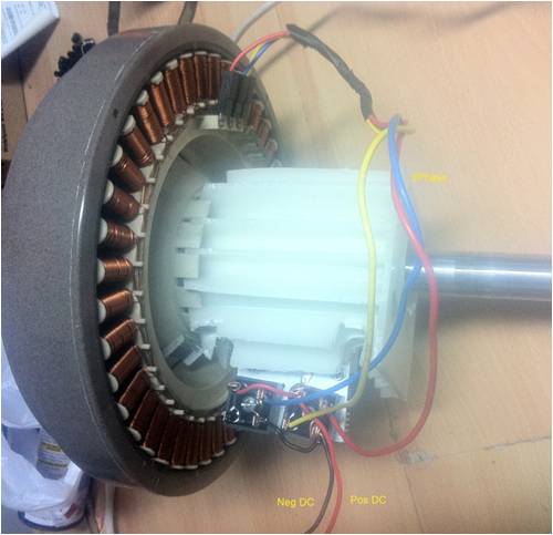

Have trawled through but can't find any similar problem so here goes.
I have an unmodified 80S stator which I have now decogged. Unloaded it spins beautifully and makes lots of volts eg 60v when spun by hand.
When I hook this up to my 12 V charge controller and batteries, which is effectively a dump controller, it is as if the motor is shorted and barely spins. ie takes a big effort to spin it by hand. Volts go up to 12 immediately with 1 amp. Wind would never spin it. When I actually short out the motor it is even harder which I expected.
I know it needs rewiring!
Now the 7x2c is what is recommended.
My concern is that I am going to go to all the trouble of rewiring and find it still doesn't spin.
I don't really mind if I don't get lots of amps out of it, I just want it to spin.
Has anyone else tried the unmodified stator and found it hardly spins?
Will the 7x2c make a magic difference?
Here is my connection setup.
$@#&*....the word often heard in my shed when it doesn't go to plan!

Gary, a connected meter puts about zero load on your F&P - easy to spin.
A 12V battery puts *heaps* of load on your F&P if its unmodified.
Try to connect a 12V light bulb (10-20Watts) to it to see it producing power while spun by hand.

Hi Gary
The set up you have there looks identical to mine. Mine will spin freely untill the voltage output reaches 12 volt which is somewhere around 40-60 rpms. so up to these rpms it spins very freely. After it reaches these it starts to become loaded up. When it reaches around 1 amp it becomes very hard to spin you either need a strong wind or a big windmill to push the amps up higher.
If your batterys are flat a load will come on as soon as you start spinning it, but if your batterys are charged it should spin freely at slow rpms untill the output reaches and excedes the voltage in your battery.
I beleive that running the 7x2c set up, the load will start to come on at a higher rpm as it is puting out less volts but there will be more loading when it does come on as you are producing more amps. I have had no experience running a 7x2c but i am guessing this is what happens, some one else may be able to come in here.

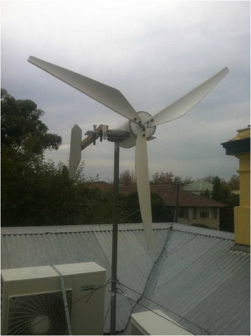

This is my current set up which is for a small but heavy treadmill motor.
It produces 6 volts at best, which is why I'm replacing this with an F&P motor.
Treadmill motor specs (120v, 5amps, 4000rpm) mean it needs much higher rpm to achieve anything. A lot of work for nothing really. Just looks good when it spins.
Will be aiming for a sturdier pole/tower for the f&P.
Was considering using the same fly wheel to attach to the shaft of the F&P but will need boring out. Current radius of blade (pvc) is 75cm.

You have already said the answer " I KNOW IT NEEDS REWIRING "- rewire it and try it again.
I would suggest 2x7p Delta for 12v, and even then the cut in might be to low and stall the blades, especially if they are just PVC pipe blades .
An unmodified stator in 12V star, which is what you have there will be producing amps below 30rpm . You will notice if you spin it very slowly there will be no load untill cut in and then it will load very quickly and heavily

Posted: 12:31am 15 Jun 2011
Hi Noel,
Have just completed the rewire 7x2c.
Decogged it as well by rounding the poles.
Now gets to 12 volts when spun by hand at about 120rpm ie unloaded.
I tried it loaded spinning by hand and it certainly now spins fairly freely and gets to 12 volts. I couldn't spin it faster by hand but saw the Amp meter just starting to flick upward.
I am still on a HAWT project as I want to use the old infrastructure and am not far off reconstructing it.
I really need the wind to spin this faster to check the amp output.
I will post images when the project is done. Hopefully a couple of weeks away.
So far promising.
I like the fact that if you can get another stator, you can just replace it rewired in another config to get a different output. Have one in the wings if this one doesn't produce the goods!
Cheers Gary
