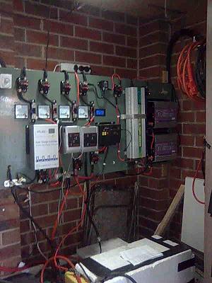

Fernbrae
Joined: 06/10/2007
Posts: 7
Posted: 12:22am 16 Jun 2011
This is a picture of my set up
Living loving life always

Fernbrae
Joined: 06/10/2007
Posts: 7
Posted: 03:19am 16 Jun 2011
Hi Xmaswiz,
I paid USD$125.00 each for the two that I purchased, I was a bit lucky as I had them shipped to one of my suppliers in China and they came to me in a container with my suppliers order.
They work well and have the anti islanding function , so will not fry a servicaman .
Thats the only reason I purchased then .
Warranty is the same , they also have just developed a waterproof inverter for connecting onto the panels at the rood area , 1x per panel like another system I saw in the USA .Looks interesting , but was expensive , I prefer what I have already .
Their wind option looks interesting , but as you say requires an external dump load.
