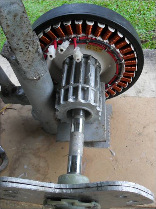

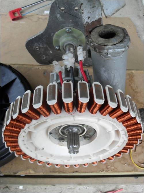

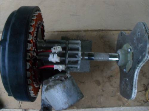

Making some progress on the cogless motor.The 36pole stator is wired as 1s-12p delta,for max amps I just need to add the blades & tail to finish.Another thing when spinning by hand the Whirring noise Fisher & Paykel seem to make is hardly present on this motor. Will post more updates when complete

Great thinking there Just a couple of things there i can see is that a u bolt holding the plastic/alloy bering holder in place ? good thinking but maby add another 2 and i would put a little more offset on it just to help with furling.
what type and size prop are you going to put on that beast?
