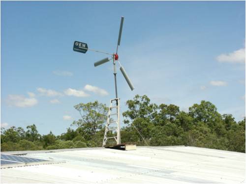

And welcome to the Forum, I have several wind turbines mounted on my shed roof and found it OK not the best but a good trial.
To get reasonable wind into it it has to be mounted 3 meters to the shaft above the roof, on the funneling effect you mention that works a bit as the wind speed increases but a slow speeds, below 4 MS the boundary layer drag on the air actually slows the air a bit. This little mill is the most efficient i have played with over the years and will start up generating at 1.5 MS but needs 10 MS to put out useful amounts of power.
I think that from a practical point of view for non obtrusive power collection the solar panels are the way to go, but not much fun unfortunately. Grab a government subsidized unit around 3 KW rating while the offer is still there, and play with the windmills until a easy to build VAWT becomes sorted, something that will do over 500 watts in a 5 MS wind and isn't to high as to upset the council.
