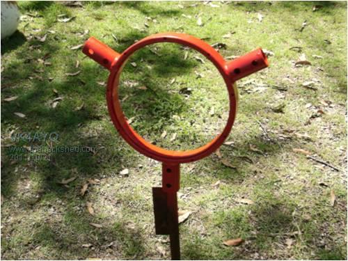

Hi norcold

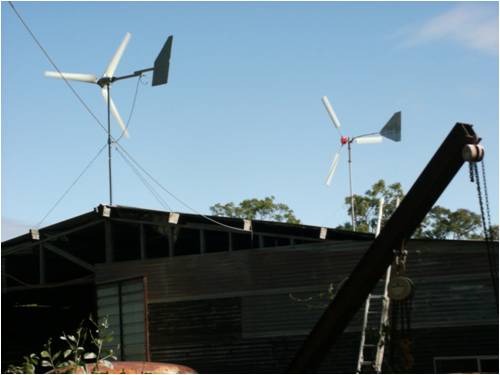

I would suggest that you match the blade loading on the two mills so they perform more or less the same and then series the two to get higher voltage, if possible wire them to delta as this will give a efficiency increase of nearly 30%.
The photo is both mills in the same wind 4 MS OEM producing 300 watts and the 500 watt version of yours producing 90 watts.

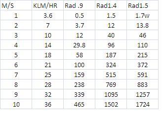

Below is a table I made up showing what output can be expected from different Dia/Radius blades , this was done using the Blade Caculator at the warlock site , there are other caculators "Altons" that I think Bob has used in the past.
It shows 3 blade sets R.9m R1.4M & R1.5m and what is the predicted output in wind from 1m/s to 10m/s , the tsr was 6 and the blade eff .3 for the R.9 and EFF of .4 for the other 2 which are the GOE222,it is debatable as it goes against Betz's Law. One thing the table points to is that size does matter with wind turbines.

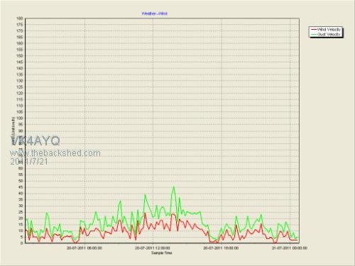

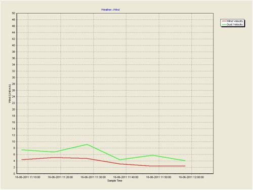

If you go to the PICLOG page HERE where my 48V Mill is logging and put in 24/5/11 and 25/5/11 into the Dates filter and hit apply , it will bring up 2 days where I had reasonable wind . If you then click on the WIND V POWER , it will bring up a scatter graph and by running your mouse over the dots it will show the output for a given wind speed .
Because my annemometer goes up in 3 klm increments it will give a number of outputs at a given W/S , I usually go about the middle.The annemometer is a Davis and is calibrated to my Davis Weather station so it is fairly accurate.
It pretty much traces the output of the graph for a 2.8m blade set give or take some wild readings that are in the middle of nowhere, and taking into consideration that that logging will have a percentage for error. For the application we use the loggers for it can give you an accurate enough idea of how a mill is performing which can not be done by watching an amp meter and assuming windspeed or even trying to watch a cheap annenometer that updates every 120sec, which is what I tried a few years back.
Getting some form of logging would definatly shed some light on what is happening.

The readings was with the anometer radio thing in my hand and it updates every 5 seconds, standing watching the amp meter' and volt meter on the mill so While it isn't logged every fraction of a second it is really a good indication. Those blades are better than you give them credit for, as they have a CL of 2.4 as compared to altons at 1.3.

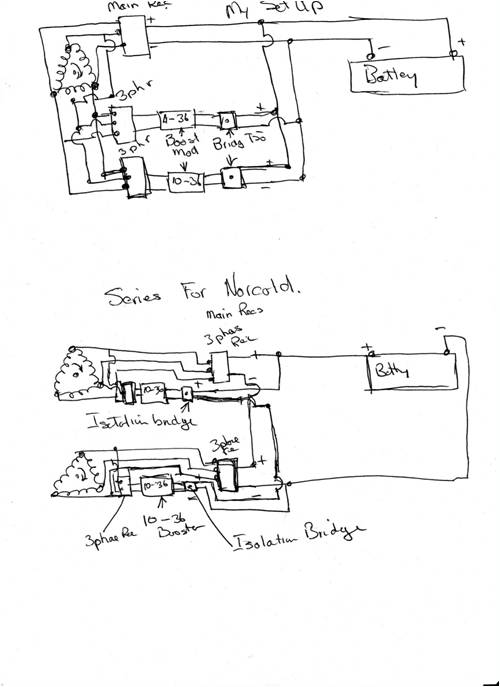

I was talking about putting the mills in series and using delta with two boosters on the output also in series to get the voltage up while maintaining efficiency.
I will do a mud map and post it tonight as at the moment i am trying to get some chink junk working.

Hi Guys
Sorry it is a bit rough, but I got the shakes a bit.
First one is my mill with two boost circuits on it
1 a 4 volt to 35 volt at 3 amps
2 a 11 volt to 35 volt at 9 amps
each has its own input 3 phase rec and a bridge on the output for isolation.
Suggested for norcold
two mills wired in series and delta connected with a pair of boost modules also wired in series and isolated bu bridges on the input and the output.
