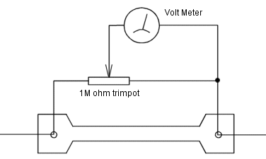

Hi all, I am looking for tips to fairly accurately measure amps, up to 100 amps @ 12v, without spending too much money. I only have a 10 amp multimetre
Anyone got any ideas?

Posted: 08:57am 19 Nov 2006
Need a shunt. On my big old amp meter I used a length of steel plate. Its about 100mm long, 10mm wide, and 1mm thick, with a bolt hole at each end. Add a voltmeter and a trim pot to calibrate the scale. Then you just need to adjust the trim pot with a known amp draw.

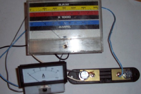

Hey Glenn, love your shunt/pot combo.
I just bought a 50 amp & shunt for $41
Then the very next day found the bigger meter in a garage sale for $2
Works fine but must have another internal shunt as 2A reads 1A 10A reads 5A etc.
It's always halve the real current draw.
I'll just change the graphics from -10A/+60A to
-20/+120A
If I want to re-calibrate a meter by looks of your diagram you can do it with a pot.
So a 10A meter could be turned into a 100A or 50A meter, am I presuming right?

Posted: 12:47am 22 Nov 2006
Yeah thats right, but you need to watch the power dissipated by the shunt. A shunt designed for 10 amps would get very hot with 100 amps flowing through it. Thats why I used strips of steel plate. Any bit of steel will show a voltage across it when there is current flowing thought it, even a 4 inch nail will do. So I rig up the steel shunt, pull some current through it, like 5 amps, and adjust the meter using the trimpot to read the correct value. Thats it, calibrated.
