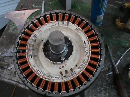

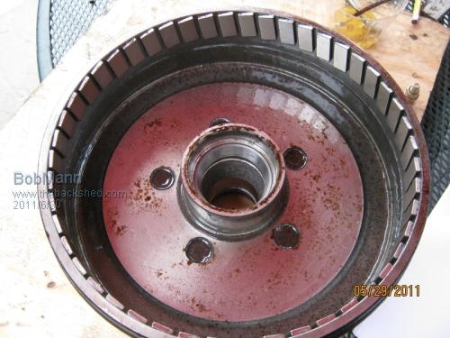

Hello I have been viewing your site and say you guys are way ahead of use here in the States.
I am the builder of the Tree Top Wind Mill here in the USA just out of Boston MA. I have beed working with you Smart Drives for a while and have found them to being supper.
I have changed my Wind Mill over to use your Smart Drive but what I have done is made some changes to it to make it a
low cost power unit I hope you like what I have done.

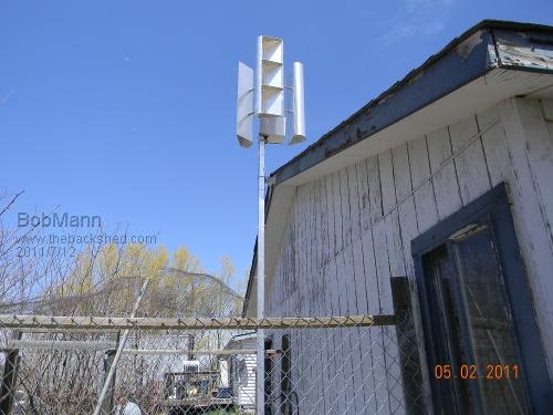

Here is my Tree Top Wind Mill with the Mann Smart Drive I know I changed the the name but I did do a lot of upgrades.
Here is the back side of the power unit
Here is the drum with the upgraded NeoMagnets
I use a premade steel drum with HD bears and hub that will take 3500 LB of
load all day long and is water tight. The axle shaft is ready to go just some machine work very little.
Please let me know what you think good or bad.
As I said you guys are way a head of the USA but I am trying .
Bob Mann

Hi Bob
The generator looks good, very solid. I will be interested to see how it goes with the NEO magnets.
Looking at your blades though I think the may be subject to flutter in turbulent air due to the single mount point on the generator. Maybe a star stabilizer on the top would stiffen it a bit.

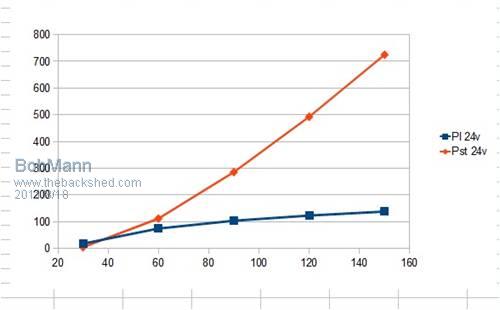

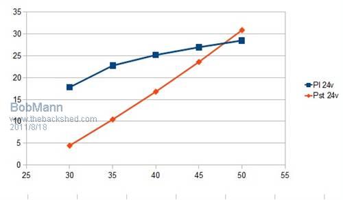

Here are some spec for the Wind Turbine with my Drive.
> Best case, this is what you can expect from your turbine:
> 10 mph 23 w
> 15 mph 75w
> 20 mph 190 w
> 25 mph 330w
> 30 mph 645 w
> 35 mph 1000w
> 40 mph 1500w
> 45 mph 2300w
> 50 mph 2900w
> (The alt would probably melt on those higher powers)
> So what amount of power should I design to handle?
This is from off site back up testing
On my wind tests on my truck my RPM = Wind Speed was more like
10 MPH = 100 RPM
20 MPH = 200 RPM
with out a wind tunnel it can be hard to get real good data.
I do now read wind speed and Watts,AMPs, KwattH, Volts into the grid.

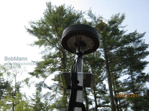

My views on this has been we need to suck the live out of ever bit of low ground level and high level winds we can. If we can drive the cost of the units down we can off set the people of worlds cost of energy and make for a bettery live style for all.
We have so much off the self stuff just laying around. If we assemble it in the right order we can make change.
Bob Mann
Below is my tree top mount and in the upper corner on top of
the tree your will see my crows nest 90 ft up for testing.

Hi Bob
Very impressive, you must be watching those logging guys on the TV.
All the best

He He love your tower me and i bet most others have thought of doing that!! You had the guts to do it!
just don't get hert it makes small wind power look bad for us all.
