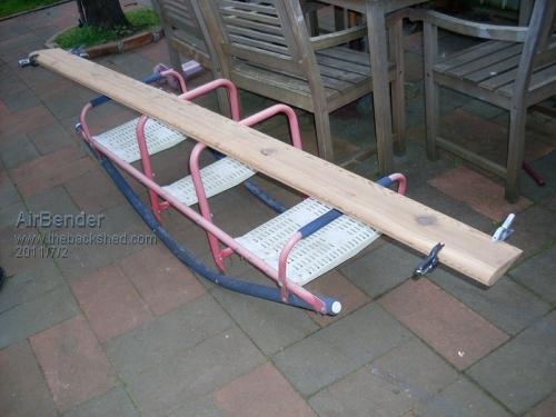

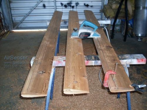

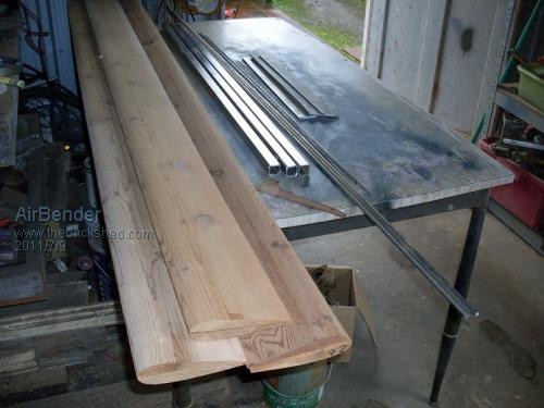

I have finaly started a bigger wing build having pushed a few other projects aside for now. We have only had light winds for the last couple of weeks and the mill has not been making much power, which has got me going.
The new wings are being built out of cedar weather boards, I chose cedar as they should weather very well.
They are 2m high twice the hight as my old ones and they have a cord width of 14cm.
Each wing is made of two weatherboards that i plan to stick together with liquid nails and a few wood screws. But before i stick them together i plan to hollow out the inside, apart from where the mounting points are to lighten them up as much as possible, as i am doing this i will start to weigh them they so i can get a good balance.

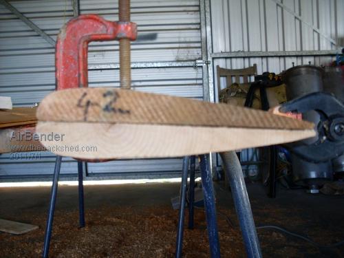

The profile has been roughed out. Hopfully tomorow I can get the sander out and finnish the profile off.

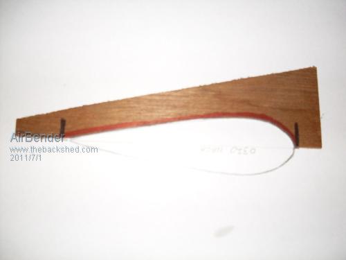

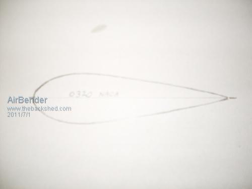

The profile I have drawn up I have calculated to be a 0020 naca. Which i hope will give me good start up and low to moderate wind performance. I plan to run it with 0 deg AOA, but as we know our best layed plans can change.
I have just made up a plywood profil stencil to use while sanding them.
I think i will need to beef up the rotor arms a bit. I think these wings will realy try out the structure of the rest of the mill.
I will try to keep you updated with this build as it progress.
All the best Dean.

I beleive i have miscalculated the naca, after recalculating I came up with 0028.
All the best Dean.

Looks similar to GOE222, is that right?

It is a bit diferent to the GOE222 which is not symetrical.
First i drew up what I thought looked good, then i looked around on the net for similar profiles and how they perform for confermation. One place I looked in was Smithys link to fluid modelling, which i am not shore how acurate the simulation is to real life but it did get me in. The one on the link that i found closest to mine is the Remkick 5 which seemed to have good perforance in the areas i was looking for. Mine is not an exact copy of this it but looks similar.
All the best Dean.

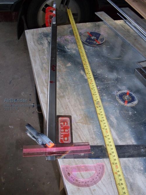

I have found there is quite a few different ways of coming up with certain definitions when it comes to vawts which makes it hard to share information at times.
I think you will find there is a fair bit of difference between the Remkick 5 profile and mine and i am shore Itsandbits would agree, it is just that of all the other profiles i have seen on vawts, his is the most similar in dimention but i am shore there is a few more out there that i have not seen.
The wings i have on my mill at the moment have 2 elements which enable the camber to be ajustable, so i have taken this into consideration when i drew up the profile.
This profile hopfully will be good for pushing the FP but may not be as good on other alternators, and I doubt that i have it right yet. Murphy would confirm this. So i woulnt be surprised if there is another wing build down the track.

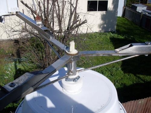

I have sanded the last wind and have the steel for modifications I am doing to the mill structure.
I plan to still use the original rotor hub but every thing above it will be replaced.
The hub has a lenth of pipe that fits over the original F/P shaft ond has sleaves fitted at the top and bottom to make it a very neat fit on the shaft. On top of the pipe I have welded a milk pipe nut which has 5 sides to which I have welded 10mm plate for the rotor arm mounts, and to thest i have braces welded domn the the pipe. In side the pipe nut i have fitted plastic spline out of the original wash tub.
I took this picture when i was measuring up the the diameter.
This is how i worked my AOA.
All the best Dean.
