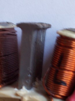

Hi Guys, I think this needs it's own thread as it's pretty complex, and basically determines what these will produce.
Megawatt the pole fingers are 4.5mm wide 27mm across and 28mm high, thats to the plastic former. It gets quite meaty inside the former, about 10mm thick ring all the way around I think. It needs to be thrown in a fire to really know.

Measured the pole tops. As you ca see from the Highlanders picture the sides of the top are rounded. Even though the picture shows a stator thats been slightly decogged, it looks like there is a slight rounding from factory. The widest part is 10mm, but this drops down to 8.5mm at the very top where the air gap is.The length of the core I measure at 25mm, not including the plastic.
