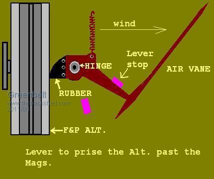

Rastus
Here's another Rough Idea, all Mechanical,Perhaps something similar could be useful?
------Cheers, Roe

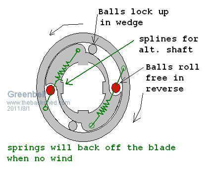

domwild
Here is another Possibility,
Most of you are familiar with an over run clutch. a device that is built like a Roller bearing with an oval race. the rollers are forced to climb an inclined plane by the outside portion of the clutch which would be connected to the turbine blade,
As the outer part rotates the rollers bind up as the clearance between the inner hub
and the outside ring diminish. this effectively locks the turbine to the alternator.
Sometimes the clutch can be found on Gearboxes.
If custom built it may be possible to get 1/3 free revolution before lockup.
------Cheers, Roe

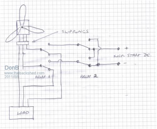

A small anemometer type thing could be mounted on the mill and would drive a set of contactors or electronic switches that would pulse the coils.

I have been throwing out a few Ideas that would not require another set of wires up the Tower.
A simple Gadget that can do the job would be cheaper and more reliable, The things I suggested would need refinement there is surely a widget that will do this,
----Cheers, Roe
