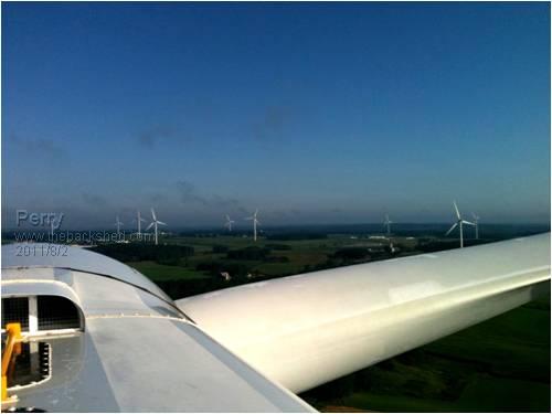

Posted: 09:21pm 01 Aug 2011
Hey Mac, Wes,
Remember if you use Altons calc that you are getting rotor power. It's basically a rotor calculator. You will still have to account for alternator, rectifier, and electronics losses. Your actual electrical output will be anywhere between 40-75% of what the calculator shows you.
You get your shop up and running yet Mac?
Perry
P.S. Sitting up top eating my stale sandwhich with a view tonight!
