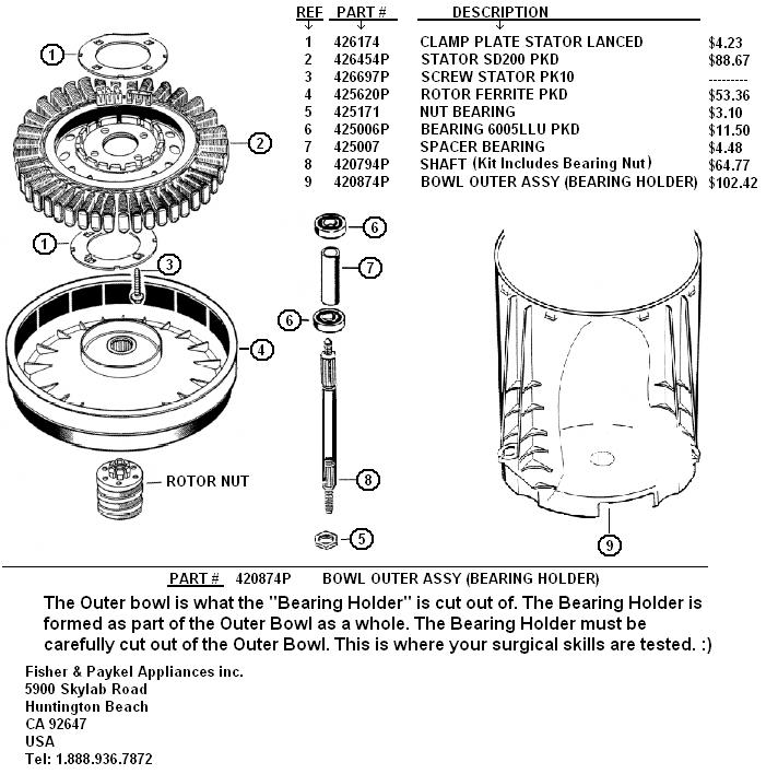

I just recieved my new 36 pole Stator and new Rotor.
S&P Parts place said that some #s have changed on parts.
Stator Part #420775P changed to #426454P ....and
Rotor Part #420774P changed to #425620P
I found a F&P parts place in California USA, if anyone needs the info here it is with part #s. I believe the part #s have changed for the new Stator and Rotor and are reflected in the pic below.

one thing i have noticed is when my new rotor arives it has a plastic bolt for the rotor nut, not the rotor nut as shown in above expanded view.
unsure why as i have not purchased the stator and rotot just the rotor for the 7 phase conversion
is the shaft different on the new machines?
martin
free power for all
McAlinden WA
Steve9R
Joined: 24/01/2006
Posts: 72
Posted: 09:10am 15 Feb 2008
Yeah thats right.. the '7phase' magnet hubs come with a bolt type nut.. thats normal.. dont use it.. just pull the normal plastic bolt off one of the old '3phase' magnet hubs and put that in instead.. then you can use the old shafts..

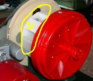

Posted: 06:00pm 01 Mar 2008
Bruce... What is this part you used here on your testbed? I've got one of the old bearing holders that was cut out of a whole tub, but this looks like a different type of bearing holder that would work well for what I want to do.
If it is a bearing holder do you have a part number so I can order one. Looks like I could easily mount it to wherever I wanted.
Brian
