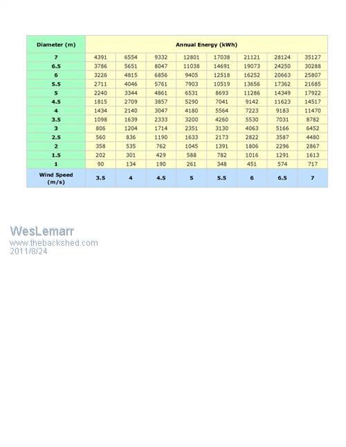

Hi Guys
I found this chart on the internet, do you think that this is a reasonably accrete indicator of the output of a wind generator? Thanks
Wes LeMarr
Posted: 01:58pm 24 Aug 2011
Maybe, if the wind blows very consistently 24/365. It rarely does

Posted: 12:00am 25 Aug 2011
http://www.reuk.co.uk/Calculate-kWh-Generated-by-Wind-Turbin e.htm
The top table is not much use. We dont know the turbine efficiency or alternator efficiency. Is the wind speed a average? I would ignore it.
The link is better, but unless you know the values to enter, its also not much use either. What is the turbine/alternator efficiency?
The only way to get a figure is through testing in real conditions. Measure the power output at different wind speeds, and make your own table of data with the values. Then record windspeed for a few days/weeks to build up a table of average windspeed data.
Unfortunately many small commercial wind turbines are overrated by the manufacturer, based on a couple of simple tests performed on the bench. Too often we hear of someone who bought a turbine rated at say, 300 watts, but after spending their money and investing time putting the turbine up on a mast, they find they average 50 watts, and only see 300 watts during a storm, just before it failed!
This has lead to a general misstrust of the small wind turbine industry. There are good turbines out there, but only because the manufacturer has invested a lot of time into their reliability and provide realistic figures.
