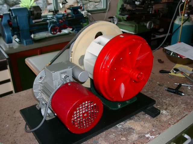

Well,the new 36 pole stator has arrived by courier. a couple of surprises !!
1. it's wound with the .6 wire(fine wire), which has a coil resistance of 15 Ohms. Each 12 poles of the 3 phases would in series.
2. The pole "ends" are "domed' as the earlier diy attempts to reduce cogging. So maybe this is a further non-cogging refinement by F&P.
So, what do u think about re-configuring the wiring?..
I'll set it up stock standard with the new rotor and see what I get turning it by hand and then into a 12 V battery.
I sort of expect lower o/p than we have been getting in the past with the "cogging" type matched with a modified Neo magnet rotor.

Well, just set it up on the bench --- get around 150v plus out of it just by spinning it by hand --absolutely no cogging at all.thing nearly free wheels at very low rpm
But.................. connect a battery to it -either 12v or 24v and whammo, can hardly turn it------soooo, it looks like I'm in for a re-configuration of the pole windings
Would like some assistance , as @ $112 I'd like to make the almost right re-config. lol.

Yes, Glenn,I've done the electrical test on the new 36 pole Stator.
Have to retake the pic's ,as my flash was turned off,and this Old Fella had to read 5 pages of instructions to get the bloody thing turned on again,lol.
1 Phase across the star point produces 244-250 v ac at 574-600 rpm.
calculating this ,I end up with 38v ac approx.before the rectifiers.
This makes me think I will re-configure the Stator into a 3phase 4 pole unit.
What do you think ?.
Also ,I'm heading towards a dual set-up with ,like you say, different wired Stators, 1 of the 3 phase and 1 of the 7 phase ,seperate rectifiers up at the platform ,then 2 wire dc feed to the workshop control panel.

Bruce, I suggest to get a useful voltage reading you would need to connect some load, did you do that or did you measure open circuit voltage?
brucedownunder2
Joined: 14/09/2005
Posts: 1548
Posted: 08:20pm 03 Jan 2007
hi Kiwijohn, Thanks for that ,I didn't have a load connected ,but maybe I could install another stator and rotor on the other side of the shaft and see what happens . I could short out 1 phase ,this should give it a load.
(I just edited a previous post to show the testbed,smallish drive motor ,but does the trick for evaluation ).
