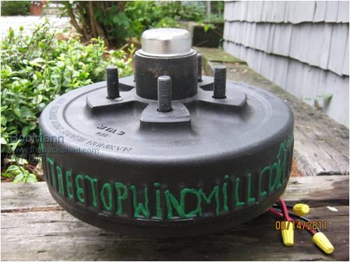

With the kind of testing and building Bob Down Under and Gizmo have done with the F&P
And What I have done with the Mann Smart Drive for wind and hydro it is a great work horse.

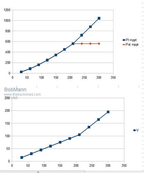

My unit out of the box it is 1000 watt unit at 300 RPM.
I would love to have one of you guys to build around it Down Under.
I have orders in the USA on EBay now. To ship it Down Under I got it down to
$200 it weighs 38 LB in the box. That was USA Post. all others UPS,FedX, was $400+

Nice solid unit you have made there, why don't you list it in the forum for sale section to let everyone know what it is and what it can do.
All the best
Bob

I am testing a duel stator one with luck today to have close to zero cogging.
After I finish painting the front of my house today I will spend some time on it.
