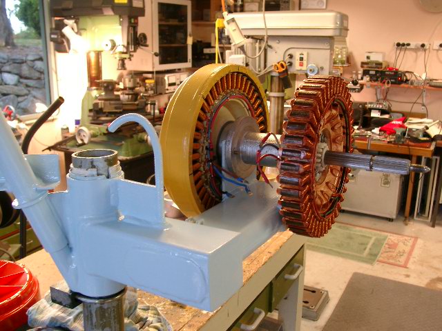

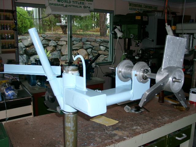

I've sort of finished my new direct drive platform apart from fitting the blades to Trev,s blade hub. In the pic you can see Trev's cast bearing holder and modified spline(extended) on the s/s drive shaft.
This bearing arrangement allows for 2 stators and rotors to be fitted on the single shaft,maybe I can off-set one against the other to sort of maybe cancel out the cogging, we'll see.
Bruce

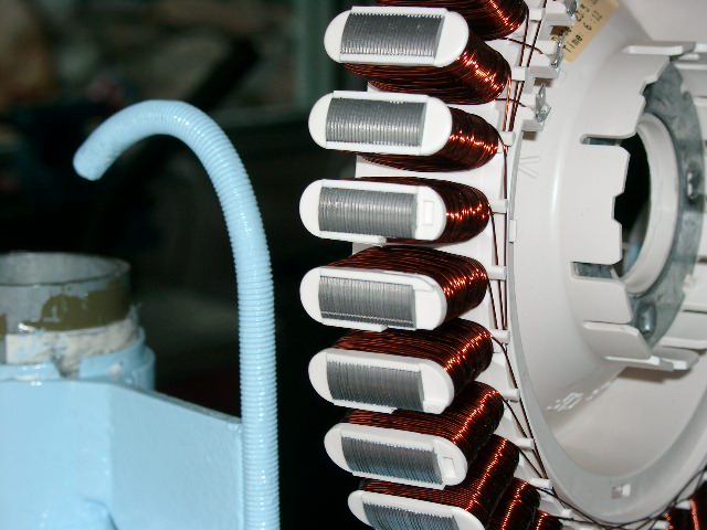

Very interresting looking stator, those curved pole ends have got me a little worried. The new stators have less poles, and curved pole ends, so there is a chance these may make less power than the old 42 pole stators. However, the fact they have virtually no cogging is a big plus. It may end up these are suitable for low wind startup, low power windmills. I can see I'm going to have to get one in and have a play.

Bruce, My next project is to make a duel hub to reduce the cogging.(started collecting already) Would you agree with my assessment of decogging adjustment?
For alignment I see 5 splines of adjustment or in other words 1/5 of a coil change per spline(old stator). On new stator it is twice that at 10 splines of adjustment or 1/10 of a coil change per spline.
In electrical terms you need 60 degrees phase shift between the two stators. If the stators are not perfectly missaligned, ie.a coil on one stator alignes with the gap between coils on the other, then the hub can be moved a spline giving 12degrees phase adjustment until on the 5th spline your back to where you started(old stator)?
Cheers Gill _Cairns, FNQ

Sounds interesting Gill, I've not tried mixing one new and one old on this extended shaft yet .
But years ago ,I fiddled around with moving the rotors spline at a time ,sort of thing ,. I remember (I think) , that it made a difference to the cogging,but didn't put the set-up on a mast to try it (just bench tested) .
I'll fiddle around today to see if there is any chance of a noticable cogging change.
Bruce

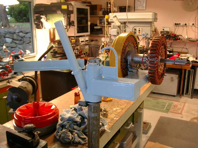

This is the new set-up. Will try fiddling around with the thing today.
By the way , anyone (Trev) got any idea of making a tool to place and remove one of these rotors ,when the special nylon nut is not used. ?. On the dual rotor set-up you have to remove it (special nut) .
Bruce

Sorry Bruce I wasn't suggesting putting an old and new on on at the same time. I was trying to get confirmation of my calcs that for old hub you have 1/4 of a turn on splines for adjustment before your back to the same cogging force. (1/2 a rotation of hub on new type). I frequently confuse myself

G'day Bruce, that new platform looks pretty flash. If I ever get around to making a second mill I'll copy that if you don't mind. What's the bit of angle on the tail shaft for? I'm assuming it's to do with furling.
As for removing the hub after the fp nut is removed you should be able to make extensions on a 3 jaw gear puller or make one from scratch. It appears you have every tool that was invented, nothing like my collection so you shouldn't find it too hard.
PS that shaft Trev made looks nice, have you got a close up?

With my double White Pointer, I align the poles of the 2 stators. I have North magnet on one motor and South magnet on the other motor. I think its the best for minimising the cogging.
Removing the magnet hub with no nylon nut ( the one at the front), I just pull it off with my hands. I guess if you have a neo conversion on there, then you probably will need to have something to assist removal. A modified gear puller should work fine.

Yes, I removed an "ordinary" rotor fairly easy by placing a board at the end of the s/s shaft ,then against my chest ,and pulled the rotor off with my hands,easy.
The Neo conversion might be difficult,but a simple 2 way puller made especially for the rotor will make easy work of it.
Got the new platform up today,direct drive ,yep,u guessed right,wind stopped immediately-but there's allways tomorrow.

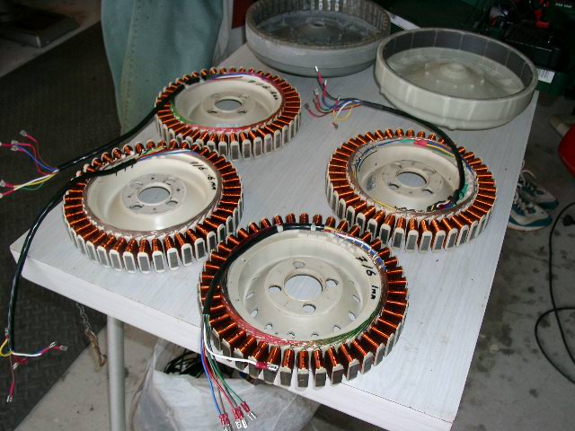

sorry ive been away so long but building a house takes a lot of my pleasure time away. I have two twin stator units made now and a mate of mine is going to be the crash test monkey for the first one. I will see him tuesday and will take photos of the unit up and running. I originally built a 4 stator unit but it was way to heavy for me to work on. I have since got a hold of an old galvanised telegraph pole that is 8 mts long, i concreted it into the ground 1.6 mts and will need to finish it soon as we are moving into the house early feb.

I did have a go at the dual rotor setup, photo's here. The problem I found was flexing in the rotor, it just wasnt strong enough to support two rings of magnets. But I think there are possibilities in the design.

Yeh thanks Glenn, i have looked at the various twin and quad stator setups and found it best to separate the magnet rings at least 75 to 100mm. I found that the rings seem to "bother each other" but can not for the life of me work out why, you see the canadians and their magnets are very close but those units are not based on manufactured motors. the single unit up in the air for the last year has been regularly giving between 12 and 20 amps in 14 pole star has run the fridge 24/7 the TV when i watch it at night and all the compact flouros, but the windmills best achievment has been the total recharging of all of my Ryobi 18 volt battery drills and saws, this house has been built using the power of the wind. We will move in in early feb and i believe 2 twin stator units backed up by a bit of solar will run a carefully controlled remote power house. i have lived in the shed for the last 9 months and have never run out of stored wind power. Even more interesting is the total size of my current storage bank is made up of only 6 trojan 6 volt T105s, wired in 3 12 volt banks of 2 batteries each, these things are unreal and were given to me by denron metals, i have to look at some 12 volt marine deep cycle batteries out of a container freighter they are about 3 foot by 2 foot by 2 foot as told to me, i will let you know how they go. have a good new year.         & nbsp;
