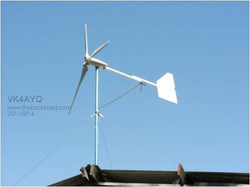

Hi old mates mate
I use a bungee tied to the tail as it lets it rotate several turns in each direction without wind up.
All the best
Bob

Posted: 07:22am 15 Sep 2011
That idea deserves a Nobel Prize for wind power innovation.
