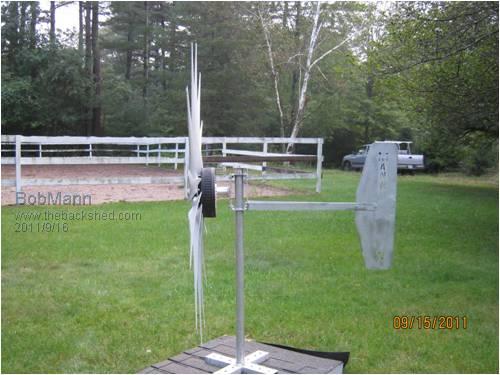

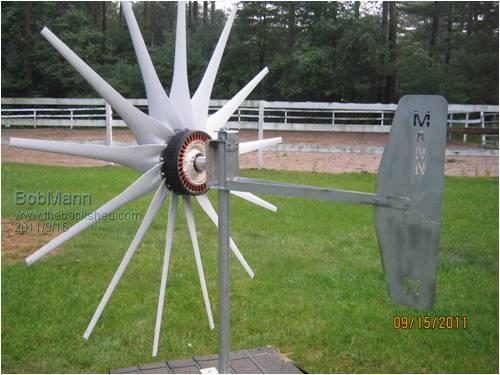

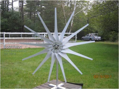

Hello I must say I love my VAWTs and they have worked just great but you guys have pushed me this way so I did it. I made the Mann Smart Drive retro kit for a HAWT.
I used a 13 blade kit and them re disigned my oun comlpete HAWT.
Here is some of the sales pitch i will clean up the post later.

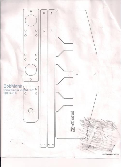

1 new 13 inch 3/8 Aluminum plate (no need to paint) with bolt holes for the Raptor like blades and the bolt hole for the Down Under Blades
The GE-222 blade profile has been used by wind turbine builder Windcharger for many years. It’s a proven performer with good all round performance. The GE-222 profile is now available for the aftermarket wind turbine industry
$65.95 Hub Plate
The Mann Smart Drive to the Missouri WS mill
Mounting Bracket that is used on all there wind mills
$29.95 Mann Smart Drive mounts
I added some tricks to the new tail I will post them later

Barry T Coles
Joined: 30/07/2009
Posts: 109
Posted: 06:45am 16 Sep 2011
That’s a seriously serious set of blades.

Bryan1
Joined: 22/02/2006
Posts: 2297
Posted: 07:38am 16 Sep 2011
A. there is no offset of the genset from the tower
B. no angle on the tail for furling
C. no tilt on the blades from not hitting the tower
All those points point towards a good build on a turbine build so why leave them out on a commercial design ??????????
Just Curious Bryan

BobMann
Joined: 30/06/2011
Posts: 134
Posted: 11:44am 16 Sep 2011
Hello it started as a up grade to Missouri WS wind mill using your F&P motor.
They have Thousands of the car Alternator wind mills in the field with that tail and mount and blades from 3 to 13 blades.
The Simplicity of my Mann Smart Drive is the fix for these low power units.
For
There is a group of three holes to off set the Mann Smart Drive
we have a Smart Drive Box that Steve has build that will control
the Smart Drive for speed and power and some very cool thing for wind farms
Plus I have added a tail adjustment system
A can be adjusted for that too but these blades have been run at very high speeds with out hitting the pole with this of set.
See with my Drive we will not need high speed to do the same job.
Bob Mann
KarlJ
Joined: 19/05/2008
Posts: 1178
Posted: 04:32am 18 Sep 2011
Bob
Nothing will control a smart drive, neos or not the design of the alternator does not lend itself to electric braking by shorting.
In fact by my experiments when the load is disconnected and the stop switches thrown it actually speeds up!
Plenty (most of us here) have been down that road and it doesnt work.
Your "design" with lots of blades and a small diameter means that the preceeding blade will crash into the spill / turbulence from the previous blade, hence, wont spin anywhere near fast enough to generate the 1000W you hope for (again neo's or not).
TO achieve 1000W out of a single stator you need a few things to happen, none of which are practical or cost effective on any kind of scale.
again there are plenty of guys who have done exactly what it takes to achieve these numbers and at the end of the day you'll end up with a pig of a motor.
Stick to claiming REAL numbers like 3-500W for single stator mills and lets see some runs on the board before the BS gets too far out of hand.
Don't take that the wrong way -everyone loves seeing the f&p get a rev up but ultimately, no one is building any wind farms with them now or in the future
as they have too many shortcomings to beat and with similar effort a decent axial flux machine can be built.

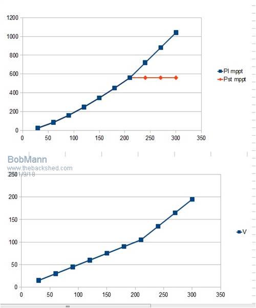

Sorry you feel this way. First you need to look over every post in all forum,s
All vid that show real testing at my shop with real outputs.
for the blades these blades I can get here in the USA they have been tested to last.
I show the 13 count because it shows well with testing we will find it it is the right match.
For my claims
Perry, you have so little faith in my modeling ability. :-)
Just to get all the info out there, this is how I figure out the power (voltage, or current) from Bob's Smart Drive.
1) OCV = RPM * 1.0 (If I ever get more careful measurements, that 1.0 might be adjusted a little, but I think it's very close.)
2) Take a guess at R (resistance) of the alt, say 10 ohms or so.
3) Current (I) = (OCV - Vload) / R
4) Calculate R based on the current: R = 7.5 * (1 + .1 * I + .03/5*I^2 + .03/5 * I^3)
The R you calculate and your initial guess will be different. Go back to Step 2 and Guess at an R somewhere between your initial guess and the results of #4. When your guess and the #4 results are close (0.1 ohms or so), you are done.
This is the method I used to generate my graphs.
Bob recently gave me two current measurements. The real results and the results of my model are as follows:
81 RPM Measured short ciruit current: 4.69A Predicted: 4.76A Error: 1.4%
103 RPM Measured short circuit current: 5.10A Predicted 5.29A Error: 3.7%
For a model that I came up with in 45 minutes or I'd say that's a pretty good fit!
All testing and math has been posted for all to chalange Sir to date I have had
No one to say that the true math and testing is a scam. I get more emails from enginers on can I test it for my wind turbine design.
Bob Mann wrote:
Perry doing the test stressed every thing it ripped a 2 inch knelled steel hub that was pressed in to 1/2 thick aluminum top tube with set screws apart.
A few facts about the test. For the 81 RPM test, 379 watts had to be put into turning the alt. For the 103 RPM test it was 525 watts.
The torque for 81 RPM was 44nm (32 ft lbs). The torque for the 103 RPM test was 48 nm (35 ft lbs).
That's some serious braking power.
Please let use know if the testing is done wrong or were in the math it is not right.
Bob Mann

"81 RPM Measured short ciruit current" ??
are you using short circuit current to rate the alt ?
this is often done on ebay with car alt conversions and gives misleading output figures ...good for sales pitch though
why not just run the mill ,measure the windspeed ....put a clamp meter on its load ...and right down both readings with a pen and paper ....bit old fashioned yes , but real Edited by niall1 2011-09-19

  niall1 said   hi Bob
This test is how the world tests there wind turbines motors real world stuff.
It all was comes back to wing design how much wind you got too what RPM and can you keep it at that RPM and what cogging it takes to brake free.
The problems I been having is I run high volts and finding the right grid tie sollution is very hard. Bob from down under has giving a way for us to control a
Swea grid tie to keep it from blowing up. To date we have smoked 5 1000 W power jacks 3 solar units in bench and real wind testing.
So I have a Ginlong inverter coming still sitting on the tarmat there.
Witch we hope is a good match.
The Winds are here now and you will have all the real world testing from the Water Tower site site Good or Bad I will post.

Hi Bob.
Is there a way you can load up the alternators with some test gear to get the actual power figures. The problem with calculated power is its never right, because other effects come in to play. While the workmanship of your windmills is very good, some of the figures are a bit off.
First up, the swept area is just to small to make that much power, unless you are experiencing a gale force wind. There's an article I put together to calculate the power available from a turbine here http://www.thebackshed.com/Windmill/articles/WindPower.asp. The maths is sound, so that will give a ball park figure on what to expect from a turbine of that size.
Also, a single F&P is pretty much maxed out at 500 watts. Thats with neo magnets, series caps, whatever, it's just it's upper limit. The problem is the design of the stator itself, lots of iron and high inductance limits its peak current. In fact the F&P can suffer from runaway in strong winds, where it will spin faster and faster, but only make 500 odd watts, so it cant be controlled by loading or shorting electrically, unlike the axial flux alternators. The F&P's saving grace is it will survive overloading.
The maths might show a power curve that rises to 1000 watts, but in reality it gets to 500 watts and flat lines. This was discovered by trial and error, a lot of trial and error, over many years. Dual stators can push up the power limit, but not double it.
Its very easy to over rate a wind turbine. And in your case, I believe unintentional. They look like well made machines, your workmanship is very good. But experience has taught a lot of us the limits of the F&P, and 1000 watts is not achievable from a single F&P.
Its better to get the power figures right now before you end up with customers complaining about false advertising. It happens. To rate the turbine you need to give a few power figures at a average wind speeds, say 10, 15, 20mph. Anything less than 10 has very little power, and over 20 is not your average wind, unless your on a mountain top.
