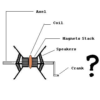

It's difficult to picture what you have, this is what comes to mind for me so I know I must be missing something.? I have included a little help for Uploading pictures,

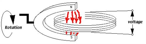

Here's a little picture to facilitate what I'm talking about so you'll better understand what I'm saying:
Study this little picture just to get the idea of how a current is "induced" into a moving wire.
The wire can move or the magnets can move; doesn't matter. There just needs to be movement.
"Force on Wire" means "direction wire is moving through flux pathway."

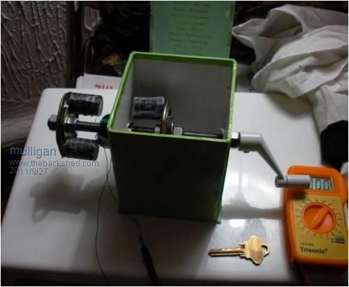

Good looks, fellow backshed members. Your timely and detailed responses are encouraging, especially in my frustration. Here are a few pictures of how it stands now,
The magnet-stacks on the outside speaker are both south side faced out, the magnet-stacks on the inside are north side faced out. Is this the way to do it? Or have each speaker with a N and S magnet facing out and align the two speakers accordingly? I will make a coil with at least 500 turns and make the inside diameter of the coil bigger. With so few magnets, will it help to have more than one coil? If so, do they need less turns? And when I connect more than one coil, do I just connect them in parallel?

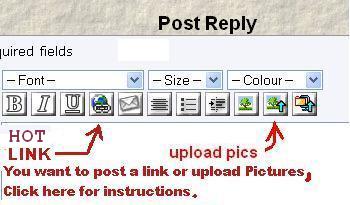

Anyways, at the bottom of the "Post Reply" box at the bottom of each page here. It's what I'm writing your reply inside of right now. At the top of the box, there's a picture of a tree with a blue arrow pointing up. If you click on that box, it brngs up another with a "Choose File" option. I like to drag my pictures to the desktop before I do a reply. That way they're all in one spot. Anyhow, just take it where it has to go and click on it, then hit "Ok". It takes from a few to several seconds for the system to upload your photos, but then they're there for all to see.
Another way, as you've attempted, is to leave a link. To do that, click on the blue "Forum Codes" button and then click on this: URL=http://www.myWeb.com]My Link[/URL
I've purposely left off the beginning and ending brackets, so the code will print and not create a blue hot link that leads nowhere. To use this, they'll each have to be left on. All you do is replace the source code by highlighting it with an apple-x (for Macs) and then highlight the link's source code and replace it. Where it says "My Link" just replace that with a word or two that identifies what you're doing like, Picture or Link or whatever. That way, folks can just click your link and see whatever it was you put up for show 'n tell.

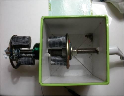

Posted: 12:19pm 27 Sep 2011
Posted: 12:40pm 27 Sep 2011
OK, looking at the photo, is the coil around the threaded bar, or out to one side?
If its around the threaded bar, then the wires are in direction of rotation, so the magnets are passing along the wire, not across them. As Mac pointed out above, the magnet needs to pass over the wires at 90 deg to the wire.

The coil is fixed to the outside of the cardboard box and DOESN'T rotate when the threaded bar is rotated. I essentially used the box as the stator.

Mulligan, if those are speaker magnets then I suspect their magnetism is directed toward each other (across the threaded rod) and not at all towards the coil as you mounted it. IOW, it won't work the way you rigged it .
Try to relocate the coil so that it is inside just one rotating pair of magnets - leave the other pair off - to prove me wrong or right. It must be inside so that the whole coil is parallel to the rotating magnets and not with the rod through the coil center.

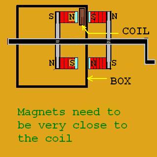

Greenbelt
Joined: 11/01/2009
Posts: 566
Posted: 09:44pm 27 Sep 2011
mulligan
---------Cheers Roe

Very nice rendering of my contraption. I had my magnets aligned as such, although the coil was placed differently; I had made the coil the identical size of the rotors diameter, so the magnets were spinning along the circumference of the coil throughout their rotation. Could this alignment have caused the "cancellation" effect I was previously warned of? With the coil set off to one side like you rendered, should the magnets pass through the center of the coil or along the outside "legs" of the coil?
