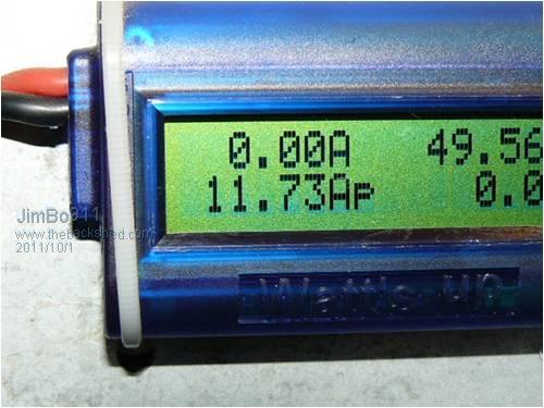

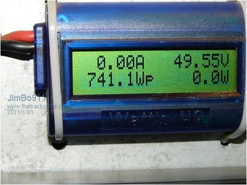

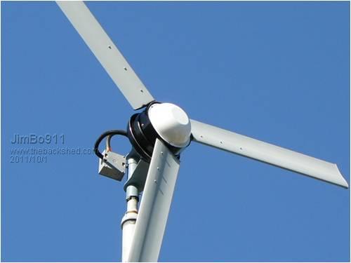

Mr. Bob I must say job well done. I guess were just gona have to put some of the AxFx machines to sleep for a short time. The tried and trued F&P rises again.
After all the fuss about lets see some real numbers I though that i might add some numbers of my own.
After crashing and burning and couple of times my 60, delta, neo set up is been flying some sweet numbers as well. 2 meter blade set with some ALU Geo blades.
My doc wattson meter tells the story. 741 Wp and 11.73Ap At full furl she pushing out about 640 watts. I could crack it up a bit but we all know what happens when we sass mother nature
Been designing a duel stator mill but it may take awhile I am really happy with a mill that keeps putting out the KWH.

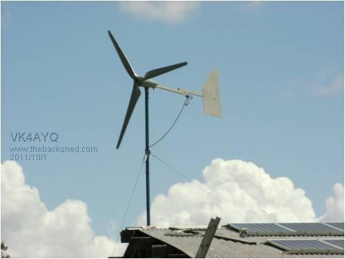

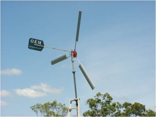

Hi Mac
The altons calculator has several variables such as CL, TSR, and airfoil efficiency and to work it backwards you need to take into account that his blades are a different section and all these things vary, On the GEP222 blades I am using they are much more efficient at lower RPM below 500 rpm, than the carved blades he is using as a standard, but more at the low end range of RPM,below 300rpm, his blades perform better at higher revs a crossover at about 800 RPM from my checking as I have two mills up with the two types of blades and can compare their relative output.
Also the Alton calculation doesn't take into account multi blade sets of high speed blades as the have a higher TSR and more blades to collect energy swept area density.
The figures that Bob used I think are direct drive from a Bridgeport mill and would not reflect a set of blades as such that has yet to come I believe, I believe a set of GEO 222 blades would be ideal for his machine as I checked them against my own calculations with my generator and a set of 3 meter ones will push past 1500 watts at 10 MS.
These are the blades that are close to Alton calculations on start and power out and RPM in wind speed relationship.
