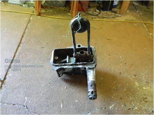

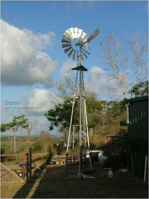

I have an old Z series Southern Cross windmill, just a baby 6 footer on a 25 foot tower. Its about 60 to 80 years old by the model I think. Looks like I will need to put it back into service in a few weeks, pumping water from a bore, so I thought I would give it a bit of a check over.
This is it when I had it up in the air in Mackay.

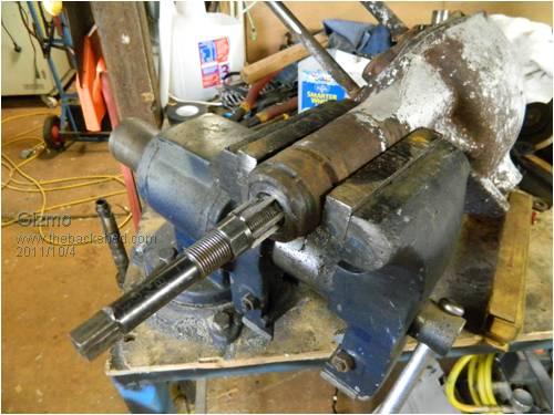

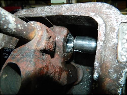

Its now in pieces, transported to my new home town Toowoomba. First I checked the main shaft for play, and it had lots, about 1mm in the bearings. So after spending a few hours knocking/drilling out pins and using my big hammer a lot, I managed to get the shaft out. It was about 22mm ( dont ask me for the imperial size ), very worn out in places, and rusty in others, so I bought a length of 24mm mild steel rod to replace it with. The bearings in this windmill are white metal, poured in place, and not easily replaced, so I figured it would be easier to ream them out to suit a larger shaft.
First I used a water blaster to remove decades of sludge and grime from the casing.

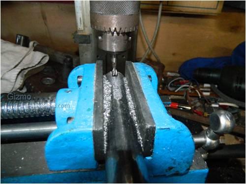

Reaming the front bearing was easy enough.
I then shaped the new 24mm shafts end into a basic cutting tool and reamed out the back bearings. The white metal is like lead, easy to cut.

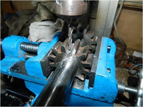

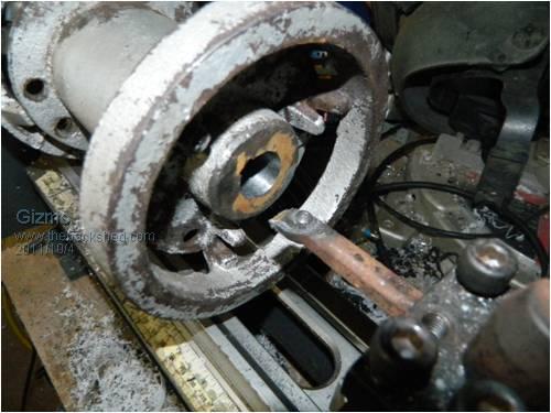

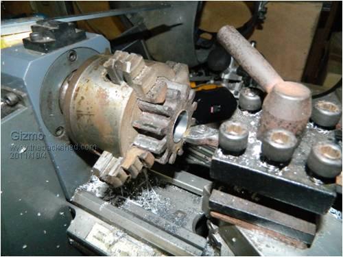

Next I machined the two small sprockets and wheel hub out to suit the new shaft.
And machined a keyway into the new shaft and drilled the sprocket pin holes.

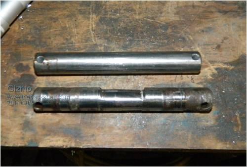

I also replaced the steel pin on th ecrank that does all the heavy lifting, it was a bit worn!

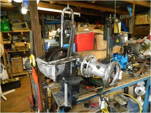

All back together and oiled up, spins nicely.

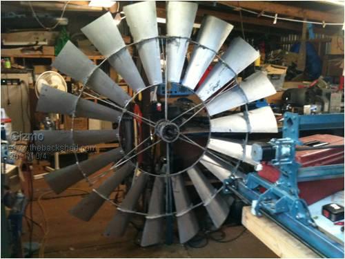

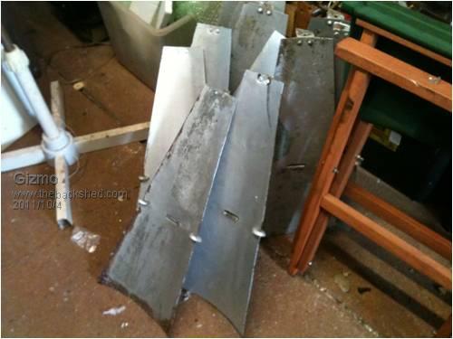

Next I fixed the fan ( turbine ). The blades were bent and out of shape, so I gave each one a basic panel beating.
The finished fan, just before I painted it. I need a bigger workshop!
Next I'll put the tower back together and get it all ready to take out to the land.

They dont recommend it, but we used a gin pole to raise the whole assembled windmill at my place in Mackay. Its very heavy, I was using the car as a anchor and at one point it was dragging the car across the yard, wheels slipping on the grass. Once up it's just a matter of climbing up the tower to fill it with oil. I used engine oil, probably a bit thing, will use gear oil next time.

That "slightly worn" pin looks like it sees a fair bit of work. I don't suppose you were thinking of using some of your "mild steel rod" to replace it with were you? Something a fair bit harder (and stronger) would be the "go". I'm not up with steel designations these days but years ago we'd probably have specified high tensile R7 or equivalent for an application like that.
Greg
Posted: 10:19am 10 Oct 2011
Hi Greg
Yeah I did replace it with mild steel. I'll check, but I was pretty sure the old one was mild too, just old!
