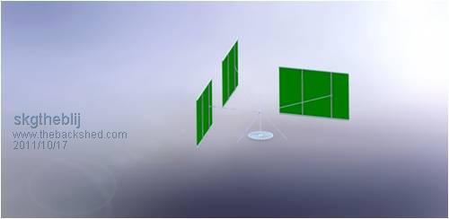

Hello,
I am currently working on an idea for a VAWT, and I think i'm stalled. I would just like to throw it out there to see if i'm missing something before I give up on it. If someone can provide input towards the issues I have with it, I may build it, but as of now, I'm not planning on it. The basic idea is a pivoting sail, which on one side is perpendicular to the wind, and on the other side rotates to be parallel with the wind in order to reduce resistance. The idea is that torque would be produced even in low wind. The biggest issue I am having right now though is harvesting that torque in a useful manner. The design which I am basing my calculations on has 3 4 meter high 6 meter long sails. So given a 5 MPH wind, and assuming that the system rotates such that the tip moves at exactly 5 mph, that is less than 4 RPM, which is EXTREMELY slow. But it should be generating a theoretical 181 N-m of torque (133 ft-lbs)(or with a 15 MPH wind, 10 RPM and 1600 N-m)
This is a mockup of the windmill. In this image, the wind is coming towards the viewpoint, offset to the right a little bit. Two of the sails are tracking directly into the wind, while the third is perpendicular to the wind, driving the assembly in a clockwise direction.
The problem I have is that I can't think of a way to efficiently harness this power. I could use a transmission system with an enormous gear ratio, but I'm not sure how to build one and I think I would lose a lot of power. I was originally thinking of buying a Missouri Wind and Solar PMA, but I don't think that even with a huge RPM up-conversion that it would be practical. The site where I would build this has usually 5-15 mph winds. Any input/insight whatsoever is highly appreciated! This is a good learning experience for me regardless of whether or not I decide to go through with it.

remember when you put a load on the mill it will slow down
yours is a different animal than what's typical
but for a loaded drag mill a tip speed of .6-.8 of wind speed is considered ideal
you could harness the torque for the same thing they have done with verticals since the dawn of civilization.
grinding grain, sawing wood, pumping water.
electricity?
dc motors are as common as dirt.
put a wheel on the shaft of the motor
you could just set one up on the circumference and let it spin.
not sure if all that was helpful or not.

From your description I cannot follow how this arrangement is supposed to work.
Perhaps if you describe a compete cycle of what the 3 sails? do and what happens to the central shaft (simply rotates or what?) during that cycle.
If your mock up could be animated it would be a big help.

the down wind side presents its full width to the wind
the up wind side rotates to present a reduced profile to the wind.
this reduces the energy required to drag the next sail into a position were it can harvest.

And Tinker, it's a little tough to explain but Electron has it right. A complete cycle of the three sails, starting from how it is in the image (and letting the sails be A, B, and C from right to left) would be:
1. as it is in the image; the C sail is perpendicular to the wind and is driving the assembly in a clockwise direction because the frame of the sail is pressing against the arm of the assembly. A and B sails point directly into the wind because they are attached offset from the center of the sail, like the tail of a windvane.
2. B sail rotates to a point where it can no longer track the wind as its frame is in contact with the arm of the assembly. C sail is still driving the assembly, and A sail is still freely following the wind.
3. C sail reaches a point where it is just beyond perpendicular to the direction of the wind, and the wind is blowing on the backside of the sail. It does a 180 degree rotation about its pivot, and the edge which was closer to the inside is now on the outside, and it is again perpendicular to the wind, leading into the wind with it's shorter edge. B sail is now driving, and A and C are tracking the wind.
4. The A sail can no longer freely rotate, and it is helping the B sail drive.
5. The B sail goes beyond the 180, and does it's 180 degree pivot, and begins tracking the wind. A sail is driving.
etc etc. I hope you get the idea.

I can see the main problem in your design being the part of the rotation where it does its 180 degree pivot, in sailing terms this is called a gybe, it is when you turn the stern of the boat through the wind and the boom crashes from one side to the other it can be very damaging if not handled well.
It may work if you can dampen this 180 degree swing down a bit or cushion it somehow.
Maybe we can harness the force of the gybe for making power.
All the best Dean.

Thanks Dean I hadn't even really considered this as a problem. I suppose my plan would be to cushion the gybe, as I was planning on having as low friction as possible in that joint in order to reduce friction during the wind following stage. Perhaps something similar to the device which keeps a screen door from slamming but causes little resistance for small adjustments? Theoretically, the gybe-ing sail might not hit anything, as it would pivot only until it is pointing directly into the wind, but realistically its moment of inertia could carry it beyond that point and cause it to slam into the front.

I think if you have the pivot point on the front of the sail and not part way back it may swing around without hitting anything but if you have anythig in front of the pivot it will slam into the rotor arm. You will find that when it swings around it will swing around with a lot of force.
Maybe this extra force could be harnessed like a turbo boost using hydrolic or air pistons. you could have your stator conected to the pole and the rotor conected on the spinning mill but sped up by the extra force of the gybe.

  skgtheblij said   Thanks Dean I hadn't even really considered this as a problem. I suppose my plan would be to cushion the gybe, as I was planning on having as low friction as possible in that joint in order to reduce friction during the wind following stage. Perhaps something similar to the device which keeps a screen door from slamming but causes little resistance for small adjustments? Theoretically, the gybe-ing sail might not hit anything, as it would pivot only until it is pointing directly into the wind, but realistically its moment of inertia could carry it beyond that point and cause it to slam into the front.
Yes, I see how it works now, the vanes (sails) are individually pivoting.
I should think it might make a noisy wind mill if you let the sail gybe freely. Even if it does not hit something there will be a 'whoosh' as it flips over.
Perhaps some shaft friction dampener might reduce that. The other thing is there would be a jerk on the shaft each time sail flips over so this thing might not have a smooth drive on the alternator shaft.
As you say, keeping the revs as low as practical sounds a good idea.

Bender, your idea of putting the hinge all the way out is a good one. My only concern is the moment on the joint to the shaft gets significantly bigger. However, I think that will be okay because I can join all the arms to the shaft at the top as well, and they can pull off each other. I'm working on modifying my model now.
Tinker, sound isn't so much of a concern, but you're right that there will be a jerk on the shaft. That will be something i'll need to work on. I think that my motor(s) will hang off the end of the driveshaft and be loosely connected in such a way that the stators can't spin (but can move up/down, side to side a little)

Caleb, I had some thoughts about your 'flip wings' today, being a sailor the following suggestion comes to mind:
1. make the 'flip' pivot location adjustable on your model. Start with a location as close to the center of the wing area as possible and still get reliable 'flip' over.
Doing that makes the area of the downwind heading part just slightly larger as the one heading upwind and the upwind going area dampens the whole process.
Gybing the sail on my yacht can be violent as its hinged right at the mast. Older type rigs (like junk rig sails) have part of the sail forward of the mast and gybing these is much more gentle.

Tinker and Bender both have very different but good ideas on how to deal with the Gybe problem. Bender says move it to the end, so however violent it can't damage anything, and I was considering making the system taller and skinnier and doing just that until I read Tinker's comment, which is to move the pivot closer to centre, an idea which I think I actually prefer.
And Electron, your idea is also brilliant, and it would kill two birds with one stone. My main hesitation with that would be making the ring, as I don't have that great of a shop. I'll definitely be looking into it though.
