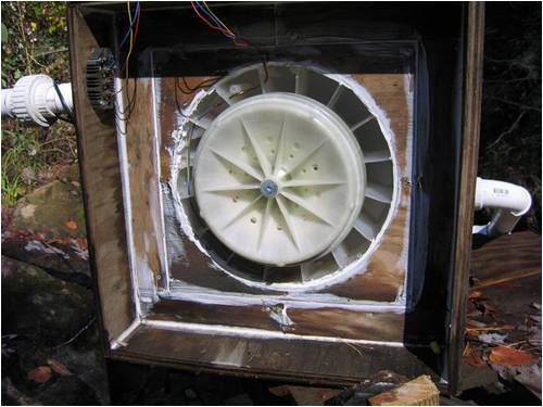

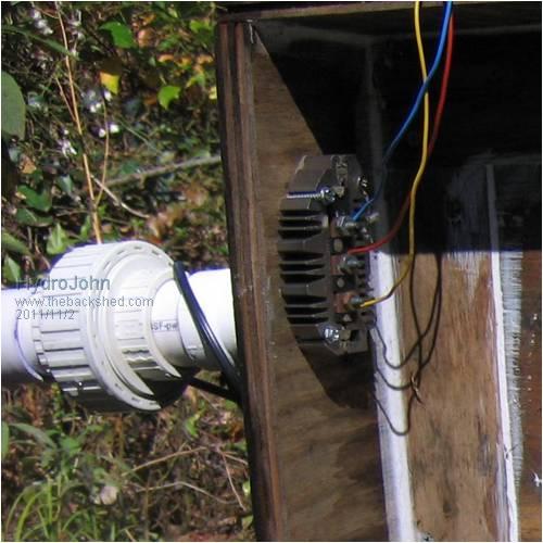

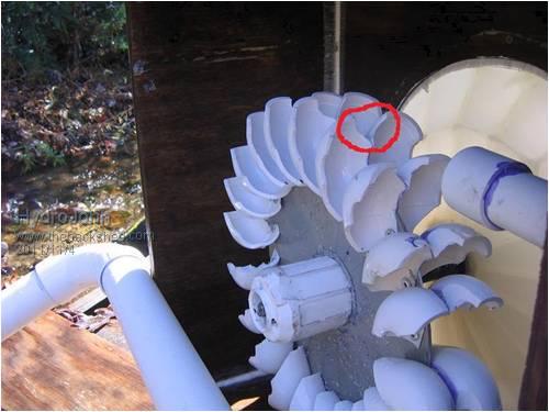

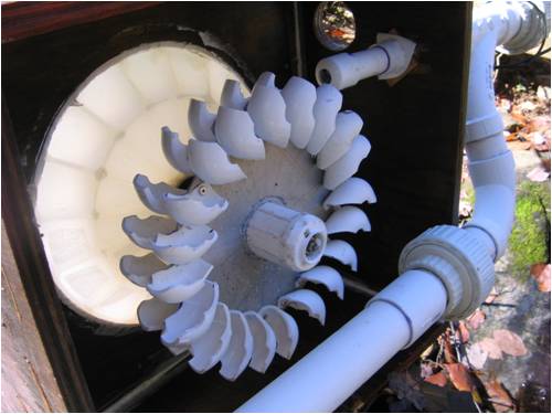

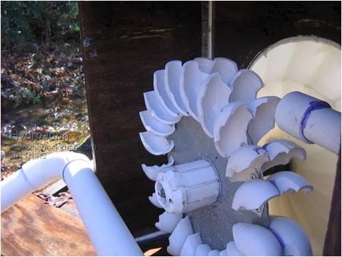

Thanks so much for all the info. I am very anxious to see the parts list from Bob. In the mean time I am going to try to attach some pictures of my Micro Hydro. It's pretty crude now, but hope to make improvements as the projects proceeds.
GM 3Ph rectifier
F&P generator mounted in plywood box. Used bottom of washing machine for bearing mount.
Home made pelton wheel. The nozzle is 3/4" hole drilled in a 1" PVC cap. I used 1" PVC elbows for cups and 1/8" aluminum (salvaged from old highway sign)for wheel. Aluminum wheel is 10" dia and total outside dia is 13 1/4". I'm sure a pelton wheel from EcoInnovation would be much more efficient.
Another photo of pelton wheel. The cups are glued together and attached to the wheel with rivets.
Hydro John

Posted: 08:56am 02 Nov 2011
Your head 7 metres and flowrate about 4 litres per second.
7m * 4L/s * 9.81m/s squared * 50% = 140 Watts. Your penstock losses are quite small with that size of pipe. As you are getting something like 3 * 13 = 39Watts, there should be some optimisation opportunities.
Two questions I have:
1. Can I charge a 12, 24 or 48 volt battery bank with the 390 volt DC produced by my turbine?
2. Can I hook my wild AC 3 phase to a grid tie inverter?
1. I wouldn't do that. To get maximum power out of the system you want to make some attempt at "matching" the source to the load. Or you waste power in the generator internal impedance, which gets dissipated as heat.
2. I wouldn't even consider this as this power level. Also you are not generating 3 phase AC at the power line frequency, so some "conversion" would be necessary.
I would suggest reading about rotor sizing, rotor speed and nozzle sizing. If you search carefully on the EcoInnovation site you should find quite a bit of free information.
Increasing the head another 10' is a good move, a 30% increase in power. If the minimum flowrate is 50gpm, unless you have a lot of storage you are not going to get much more than 50gpm. A days storage at 50gpm = 72,000 gallons, etc.
Neat idea for the buckets!
Good luck,
Dave

Posted: 10:11am 02 Nov 2011
Hi again John,
I would like to endorse Dave's remarks - particularly about rotor sizing, speed, and nozzle sizing. It really is worth doing a little research here.
While your Pelton wheel buckets look well done, it seems that your turbine diameter was dictated by the size of the piece of aluminium that you had to hand. If you could make your turbine diameter larger, then you would get more torque, although this may be at the cost of the turbine (and hence the alternator) speed.
The nozzle is also worth more experiment. Your nozzle appears to be something that would be quite hydraulically "lossy", and you might well be able to gain some significant performance improvement by re-designing it. The best nozzles are more like a needle valve, with a tapered (ie venturi like) transition between the penstock diameter and the nozzle diameter, ideally with a central "needle" for adjustment and throttling.
If you look at an adjustable garden hose nozzle, you will get some idea of shapes that are reasonably efficient. Just improving the characteristics of your nozzle may well give you a substantial performance increase without doing anything else.
One further comment from one of your earlier posts. There is no such thing as an AC or a DC heating element - it does not matter whether the current is AC or DC - it heats them just the same. Ohms law is the operative principle here.
Note though that most heating elements would be of the order of 1,000 Watts or more so that, even if you find one with, say, a 220 Volt or higher voltage rating, the load on your turbine with one of these fed with DC would be way higher than the present 39 Watts worth of lamps that you are running.

Thinking more about a nozzle for your turbine, something that you could try that would be cheap and simple to make would be to take a piece of PVC pipe, and heat and flatten one end so that the end looks something like a figure of eight. The point at which the two sides of the pipe meet in the centre of the figure of eight could be extended by flattening it along further to separate the two nozzles that this would now form.
If necessary, you could use two metal rods as mandrels to form the actual nozzles while you are heating and forming the plastic pipe.
This would give you a taper ending in two nozzles. If you can align each nozzle to be in line with the centre of each of your rows of buckets, you should gain an improvement in performance over the present single hole end cap arrangement.
You may need to use bolts or screws to clamp the edges of the pipe together where they meet at the centre of the figure of eight to permit the two nozzles to be sufficiently separated to align with the rows of buckets.
If you use a PVC coupling to connect your new nozzle to the existing piping, then it would be simple to change nozzles and try different shapes and sizes till you optimize the nozzle performance.
Looking at your photographs, it appears that you have stepped down pipe diameters from your penstock size to your nozzle pipe size. Beware of sudden diameter transitions, as these are also hydraulically "lossy". Far better to stick with the larger diameter pipe right up to where it tapers down to your nozzles.
If you do give this a try, please post your results.

My home made pelton wheel is about the same size as the wheel that EcoInnovation makes, so I'm not sure that increasing the size is going to help much, but it may be worth a try. I may order one of EcoInnovation's wheel. Will keep you posted.
I would go with Eco they have good product just check shipping cost
I like the idea of making a twin nozzle out of pvc pipe, although I am concerned that the stream of water may hit the back of the cups instead of going through the notch that is cut in the middle of the cups. Maybe I could cut a notch on each side of the cups, each stream of water would have it's own notch. I might also order one from EcoInnovation to compare.
Convert 3ph wild AC to usable 1ph 110/220 volt AC:
This is the part that is the most challenging for me. As I understand it, Don's plan B would be the following:
1) Run the unmodified 3PH AC to my house and install a kill switch.
2) Rectify the 3Ph AC to DC using a Bridge rectifier (Part No 18M3291) that Don suggests. Note: what will this rectifier do, that the GM auto rectifier that I already have, will not do?
3) Connect the rectified DC to a high end grid tie inverter and then to the home grid. Where would I get the inverter and what would be it's defining specifications? Don, do you make these and do you sell them or is it something that I could put together myself?
You are running Hi Volts a stock 60 stator you will need that recifer. Most here rewire there stators to low volts for battery charging so a car one will work for them. You need to set a limit of spending then piece it out. My name is BOB.
For a high volt grid tie there are one or two out there I like, my Ginlong 2K ran $1800. That is why we are building my Mann Smart controller so people can use the low cost 50 DC volt grid ties around $300 each with low or high volt PMAs
Thanks so much to everyone for your help and your patience.

The head that you have available is in the bottom of the range of what is suitable for a Pelton wheel. Anything that you can do to increase it by either increasing your pipe diameter, or raising the supply water level, will help. Maybe you should do both, if you can, then you can also enjoy the fishing.
I am not sure what you mean regarding the "notches" in the buckets. Pelton wheels work by trying to extract all of the momentum from the water spray, and that is done by turning all of the water flow in the bucket so it has no more velocity, and literally falls out. Properly set up, Pelton wheels can be much more efficient than any other type of water or wind turbine. Note that the optimum speed of the wheel is half of the speed of the spray from the nozzle.
If there is a "notch" in the bucket allowing some water to escape before its direction has been turned in the bucket, and its energy fully extracted, then you will lose efficiency. Maybe though I am missing the point of why you have these notches.
Some other Pelton wheel installations use more than one jet on the rows of buckets to balance the torque on the wheel. Maybe you could consider this, and put another (twin) nozzle directed to the bottom of the wheel from the opposite side of the wheel enclosure. You should also have a look at how the water leaves the wheel, to make sure that it is as clean as possible, and does not fall back and interfere with the rotation of the wheel, hence slowing it down.
Have a look at Wikipedia on Pelton wheels, as this gives a run down on the theory of operation, though I am sure that there are many more articles available on them.
Regarding your comment about what a different rectifier would do better than the GM one that you are using, the answer is nothing. I would still expect that the diodes in the GM rectifier are not rated for the voltage that you are applying to them, but, while they continue to work, then the GM rectifier will do as good a job as anything. But I would suspect that the day will come when the magic smoke will escape from them, and they will stop working, so that you need a plan B.
Before you worry about getting an inverter, etc, I would first get your turbine providing a useful amount of power, if you can. The present 39 Watts is really not worth the bother. When you can run 3 100 Watt lamps, or better, then you are getting into the range where it is worth looking into an inverter.
Don

From my reading on Pelton wheels, I guess that the function of the notches you have used with a single nozzle would have been to permit the bucket on each side to get about the same amount of water This would even up the axial force that could otherwise be generated on the shaft and bearings if the water volumes were uneven, but perhaps, again, I am missing the point.
Despite this, I still think that the suggested twin nozzle arrangement would work at least as well, and probably better, than the present single nozzle arrangement. More than one twin nozzle acting on the opposite side of the wheel would probably work even better.
Your Pelton wheel is converting the momentum of the water hitting the buckets into rotational energy. You will get the maximum momentum from your water supply when you have the optimum combination of mass flow and velocity. This will be determined by the diameter of the nozzles and, ultimately, by the capacity of your water supply, and the losses in your penstock.
If your nozzles are too large in diameter, then you will have a large mass flow, but little velocity. If your nozzles are too small, then you will have good velocity, but a low mass flow. The trick is to get the diameter just right, and this will be what you need to experiment with.
Oh yes, and some facility to tweak the aim of the nozzles would help to optimise the performance. I imagine that this could be quite critical.
