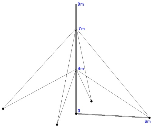

I'm planning to put up a windmill tower on my new block of land in the next few weeks. Its going to be a few months before I can build a shed on the new block, but I found out recently the bare block of land next door will be up for sale soon. So I want to get a tower up with a tied off windmill, so the new neighbours know what they are getting into before buying. If they buy and I put up a tower later, they may complain.
This is what I'm planning.
The tower will be 9 meters high. top guy wires join at 7 meters, meaning I can run a turbine up to 4m diameter, though closer to 3.5m in reality. Another set of guy wires join at 4 meters. 8 guy wires in total. I'll be using a gin pole to raise and lower. Guy wires anchored 6 meters out from tower base.
For the tower I'm looking at 65mm nominal bore medium thickness gal pipe ( OD 76.1mm ). For the gin pole I'm thinking either 40mm medium or 50mm light gal pipe. When in use I'll attach additional guy wires on the gin pole to stop it bending.
I'm not sure about a suitable guy wire size? Does 6mm sound OK, gal wire over a steel center.
Any feedback welcome.

Hi Glenn
Looks good should be very strong, the 6 mm wire has a BS of around 3 tonnes and with a 6 to 7 M ratio it should never move. 50mm RHS would be a better call on the gin pole as it is more rigid than pipe. All depending on the weight of the turbine of course.
3 or 4 strands of fencing wire spun into a cable would make a cheaper option unless you have a good source of cable.

Hi Glenn,
I can only speak from my ham radio antenna mast experiences but it was with a home built 12m telescopic lattice mast (square section) and it was guyed with 6mm gal wire rope. I had the thimbles swaged in - on my 6 ton car jack press in home made dies - and these never gave way. If you use the U bolt type wire clamps use 3 at each end.
I also used turn buckles for final tensioning and a short section of chain & shackle for coarse set up of the pre made stays.
Regarding your gin pole arrangement, you have to make sure the guy wires at right angles to the gin pole remain tight throughout the raising process. That is not always easy if the ground slopes and you get uneven guy lengths. For this reason I used a seesaw raising/lowering method after my mast was telescoped down. I had a full size 3 band cubical quad antenna up there which had a fair bit of wind resistance but my upper guying attachment was closer to the top.
If this was my mast I'd fit 3 diamond stays to the top section to keep it straight, these need only short (0.3m?) spreaders and would not rob much blade clearances if the spreaders are at the 7m level.

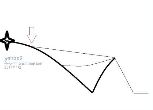

I have had a glance at my steel spec book, i assume you are not looking at dodgy old pipe but what is called CHS (circular hollow section) so CHS grade 250L0 76.1 od medium will be a 3.6 mm wall thickness. the max serviceable load on a 7 metre span would be 670 newtons.
for comparison in the same grade 88.9mm X 4mm is 1210 N and 101.6 mm X 4mm is 1830 N.
There is only one point that the poles will be loaded, I have tried to draw it but its no masterpiece, if it bounces or a u-clamp slips then grips while the tower is lowering the flex will whip the poles.
The tube is 6.5 metres standard length if you leave some extra lowering room, and move your guy blocks a fraction wider you would have an upgrade path to 13 metres, I have had a look at the weight of a few commercial 4 metre diameter blade turbines, 3 inch may be borderline for that
yahoo
re-edit ( the point between the arrow and the ground is the 7 metre span that is loaded)Edited by yahoo2 2011-11-03

Posted: 11:22am 02 Nov 2011
Now that I look at my own drawing its a 9 metre span with an load offset from center, I cant do the formula for that, here is the centered loads.
--------max service load----load to bending (damage)
76.1 X 3.6 mm 410 Newton-----3790 N
76.1 X 5.9 mm 612 N----------5830 N
88.9 X 4.0 mm 731 N----------5770 N
101.6 X 4.0 mm 1110 N--------7620 N
If gravity is causing the load its roughly 10 newtons to the KG
the reason that Bob is suggesting square hollow section as a stronger alternative for a gin pole is that it is made with thicker wall options and from the higher 350 or 450 grade steel, Australian mills dont roll circular hollow in 450 and 450+ Edited by yahoo2 2011-11-03

Hi Glenn,
If you want to save on cost and not compromise the strength of the tower,you can use 4mm cable for the lower guys.The load is carried on the upper guys while the lower ones hold the mast straight.You might consider it to much bother for the difference in price all the same!I don't know if laws are consistant across Aus,but I've been informed that towers up to 15mt in my location,rural south west Vic. don't need a building permit or shire aproval.This advise came directly from the engineer.I'm going 19mt so,still in the planning stages.Cheers Rastus

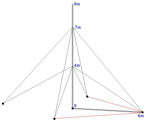

Glenn, further to my comments above,can you add to your drawing guy wires from the tip of the gin pole (marked "6m") to each of the ground anchors at right angles of the gin pole heel attachment? This might help those who do this for the first time and follow your drawing.
These extra guys are *essential* during the lifting/lowering process to keep the gin pole aligned. I found out the hard way what happens if these are omitted

Posted: 10:52pm 02 Nov 2011
Thanks for the great information guys, especially the loading details and the wire strength.
Yes I should have included the gin pole side guy wires in the pictures. Here's the pic with the gin pole guy wires shown in red.

Posted: 01:57am 03 Nov 2011
I am not sure that metal loading specs help a great deal, I cant do an accurate calculation because it is such a complex load. My gut feeling is that it should do 140 KG with some margin, but it wont look pretty.The height that the gin pole guy wire attaches makes a huge difference. Most of the failures I have seen are related to the quality of the build not the materials. Guy loops welded straight to the pole with no load spreader, base hinges that jam, seize or just collapse.
In the past I have cut the top out of a 205 litre drum, filled it with water and hooked it to the tower apex, you get it about 30 cm off the ground and bounce it around a bit, if I was happy with that I bolted a 100 Kg weight to the pole and lifted the tower.
