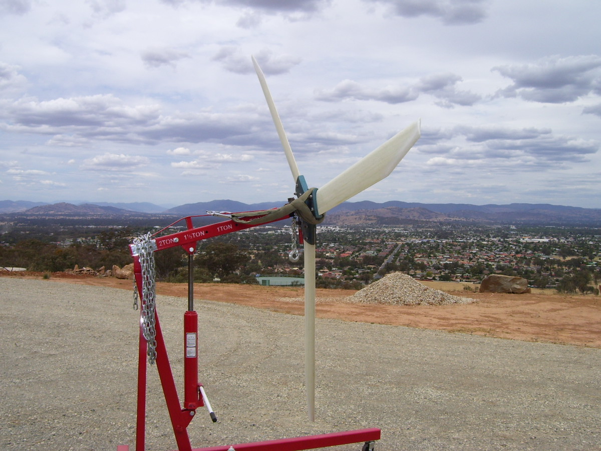

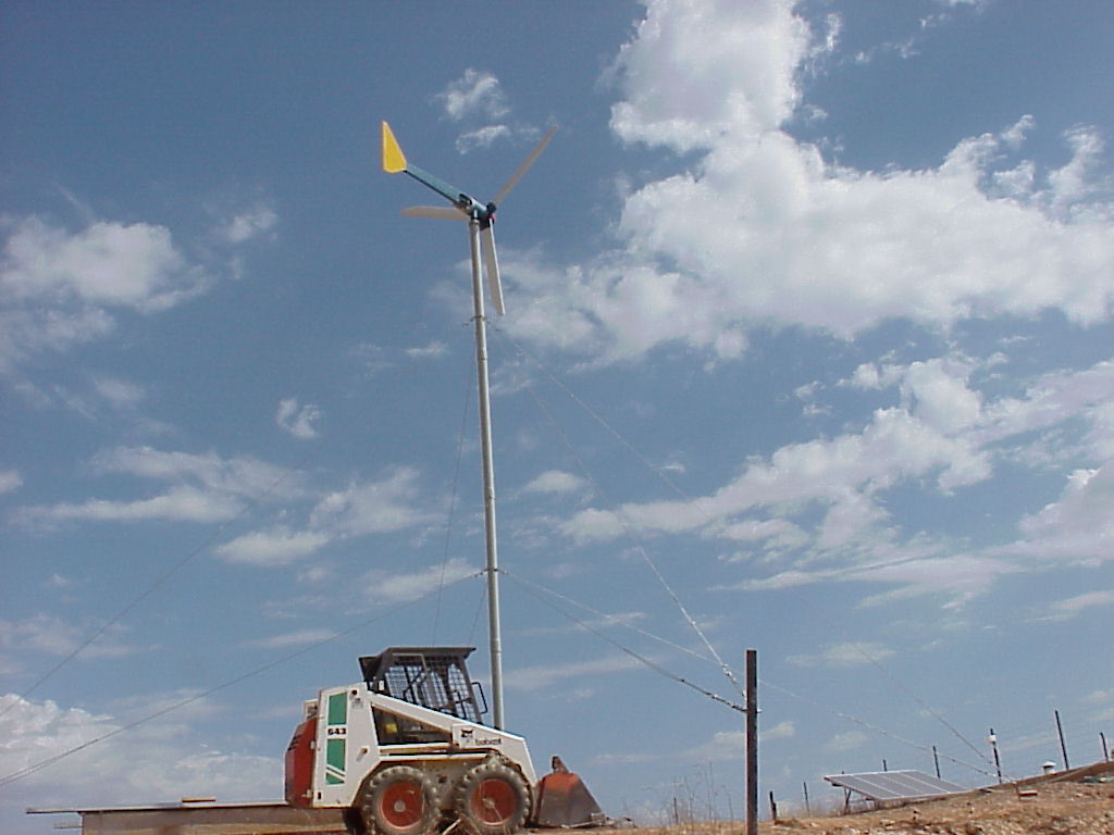

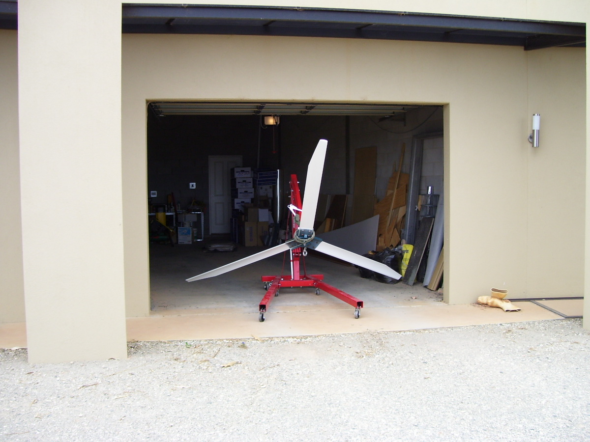

Thought I'd start another subject rather than divert the other one that started this thread. The story so far: I live on 22 acres on the edge of town, nearest neighbour is about 300m away, the next about 400, then any number from about 600-700m away. Last week, out of the blue, council turned up because they had had a noise complaint about
our windmill!
The environment dude likes the idea of windmills, and couldn't see the problem. Didn't think it was an issue, but had to act on the complaint anyway.... and it was at this point that I posted here looking for alternative blades.

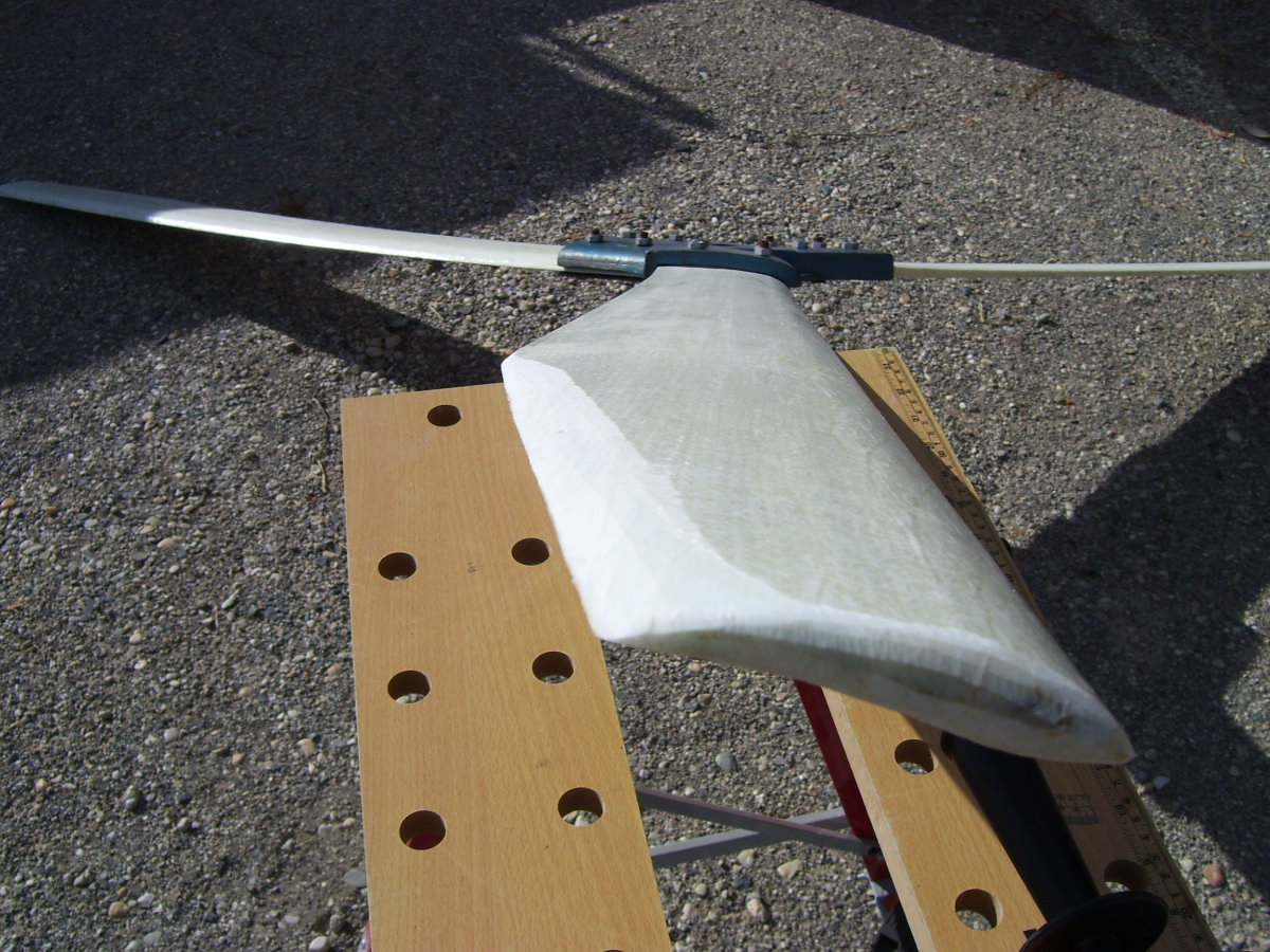

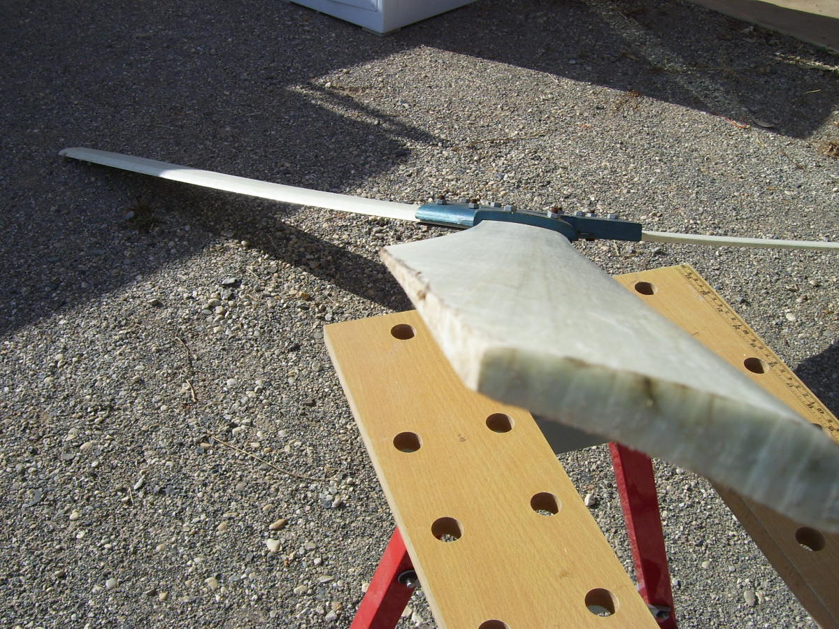

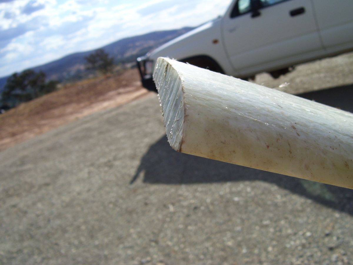

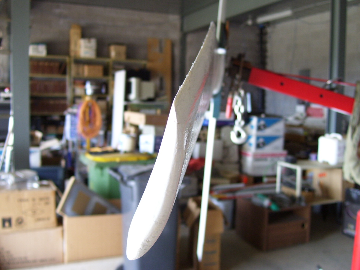

Anyhow, I decided that I'd pull the thing down and see what I could do... and a couple of things that did concern me immediately were the horrible way the blades were made. It's a 3m dia prop, the last 2 feet or so are cut back at an angle to make a smaller tip, but on thinking about it, the way they did it HAD to be a problem...
The trailing edge was just cut off square, as was the very tip of the blade. so I into it with the 5" anglegrinder to re-shape the back of the blade. The initial roughing out left the new trailing edge more like an aerofoil but still pretty rough.
Next morning, I went out and got a trailer tapered wheel bearing, and a flat-faced bearing for a trolley, a 3/4" bolt and some bits and made up an adaptor to mount the prop and hub on my engine crane. A very useful jig! I could now turn the prop to work on all sides, sand and shape. When I had the trailing edge fixed, looked closely at the leading edge and it had a horrible sharp front too, so sanded that back to a nice smooth aerofoil shape too, then sanded the entire blade set back with fine paper to get all the lumps and bumps out and painted it. Several coats, with wet-and-dry between.
Then I wheeled it all into the garage (thankfully I have a big door and 3.6 metre ceiling!
While it's hard to take a decent photo of a curved surface, the (nearly) finished blades now look like this - although I have to remove the bits of fluff collected on the leading edge.
Balanced it as well as I could, then too it back up and put it back on and immediately she started to fly! Almost silently!
There is still room for improvement, but from noise level readings I took back in october, to now, I have reduced it by over 20dB. In a 40kmh breeze now, 25 metres away, I'm seeing 51dB(A), which includes the sound of trees and things thrashing away. The turbine is audible, but not substantially over the background noise.
So Glenn, and Trev, the urgent, burning need for new blades is gone, but the desire to try some GOOD blades and a new hub (thats actually centred, not offcentre like this PoS chinese thing) is certainly there. As soon as you two gentlemen can manage it, I'll be in like Flynn!

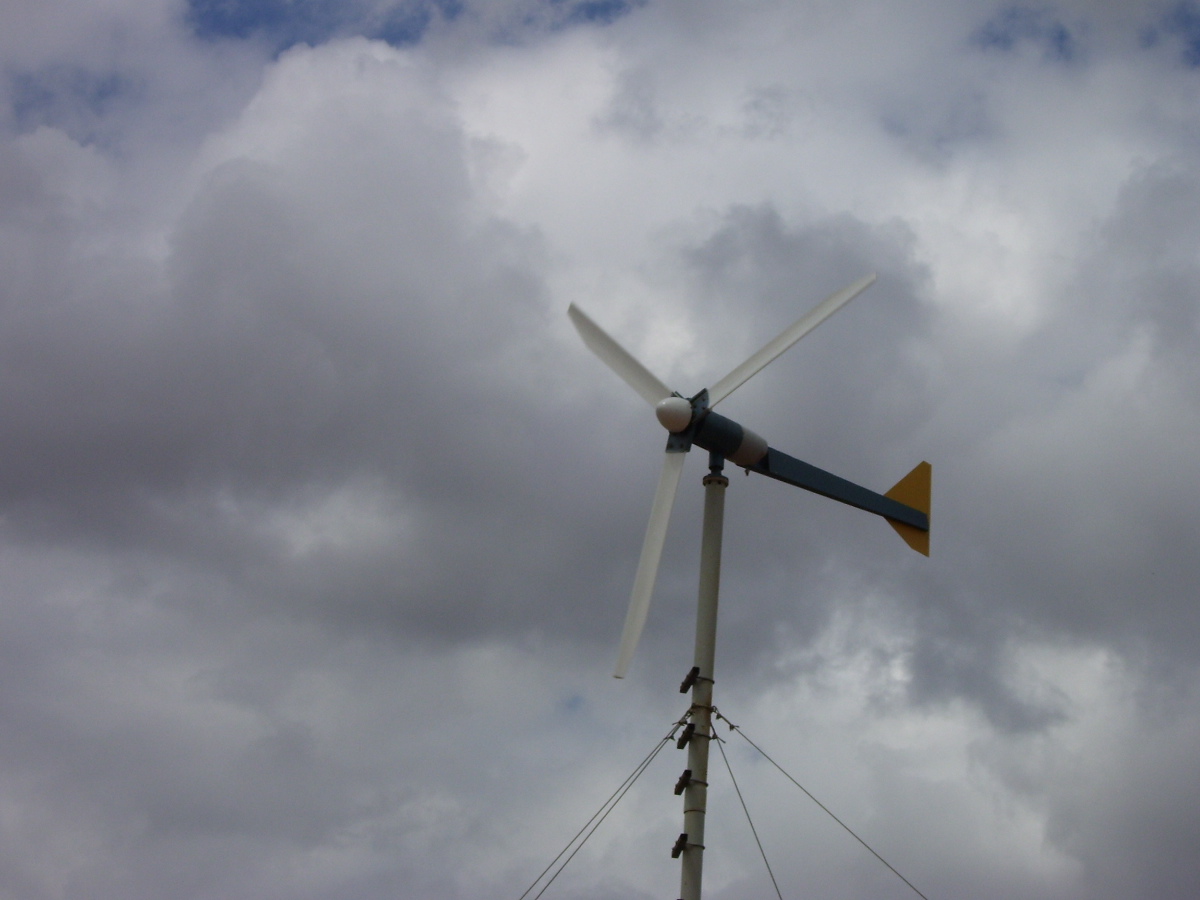

This thread was started basically, because of a noise complaint about my mill. While the complaint has been dropped (seems it was vexatious - I sent a pair of door to door godsellers packing and they didn't like it)
My attempts at silencing (well, quieting) my blades were spectacularly sucessful. Over the weekend, we again had winds over 50kmh and while the mill does make noise, it was substantially below the noise of the wind in the trees 200m away.
My work wasn't optimum, and I'm sure if I sanded them back more, and painted them properly, and wet-and-dry finished them and waxed them they would be even better.
However, your points are completely valid Trev - these blades have no twist. Mine are off the "3 metre" chinese
turbine, and have the trailing edge cut back for about the last 18" or so. The re-shaping was surprisingly easy, roughed it out with the 5" angle grinder and finished it with sandpaper by hand.
Seeing the difference this made has given me real hope. I made nearly 20 KWH this weekend from my little mill!
