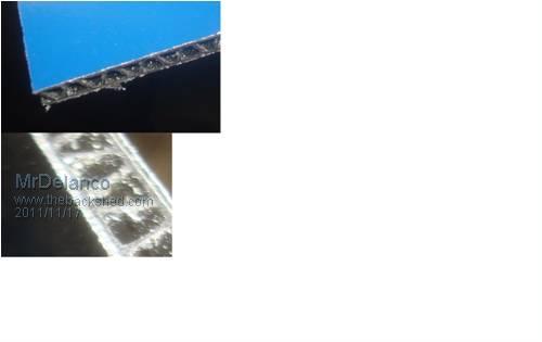

[Quote=MrDelanco] I see many blade designs out there on small home units. Do any of you have any thoughts on new blade design's for the small home units, you would like to share ?
Welcome to the 4m. Here, try THIS on for size.
. . . . . Mac
Edited by MacGyver 2011-11-18

  MacGyver said   [Quote=MrDelanco] I see many blade designs out there on small home units. Do any of you have any thoughts on new blade design's for the small home units, you would like to share ?
. . . . . Mac
Hello Mac;
Very nice work. I have used a similar material with aluminum cladding but had some whistling from the holes along the edge. How does the Coroflute you used hold up to strong winds and does the material breakdown when exposed to prolong sun-lite ?
Regards Bob.
