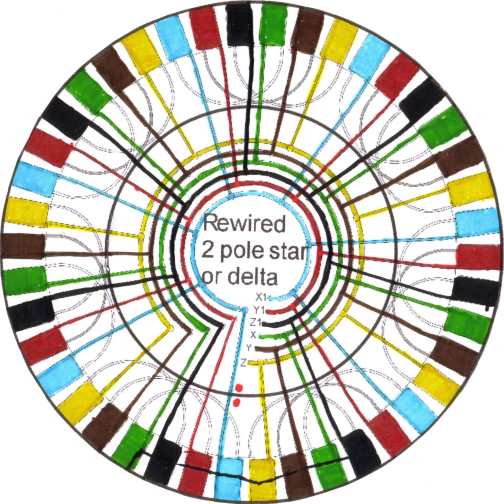

I found the information on Gizmo's site about rewiring the F&P stator the easiest to follow and with excellent detail in the enlargable images. But still come a cropper when I attempted my first rewire.
2nd attempt I took a different approach which made it so much easier.....so I thought I would share since I drew from his knowledge bank.
I decided to colour code each stator to match the colour of the wire that was to be attached. (I used 20A 7 core trailer wire.) I then resized the image so I could cut it out to fit in the stator ring.
The difference it made was incredible. I knew exactly which wire to cut at a glance. In fact I just cut all the wires as indicated, torched the ends with a small portable gas torch, then sanded each one... ready for soldering. Soldered one colour wire at a time starting from the red dots....so much easier.
Then I joined wires X1,Y1 & Z1, and used X,Y & Z as my three phase STAR output. I have the option of utilising Delta when I eventually make a star/delta switch.
...Ahhh, yes it is hand coloured with texta. Last time I did that was 40yr ago, so keeping between the lines was a challenge
The image has been resized (7") to fit inside the stator ring so straight-up print should work without resizing. Cut out the full template, then cutout the centre at the black line. The black line drawn through the lower legs of the stator ring should be cutout to, to allow fitment to the original stator wire terminals.

I'm in the same boat as you, a newbie. This was my first attempt at rewiring. DeCogging....it's something that needs to be done to the stator...I'm yet to do it. It greatly reduced the energy force needed to start the gennie turning.

The de-cogging is quite easy with a 100mm disc sanding tool with coarse disc or a medium metal grinding disc-go gentle ,don't take too much off, just slightly round the crown of the finger-be careful of touching the coils --do a few -have a rest ,sort of advice.
don't forget to varnish the job when finished.
