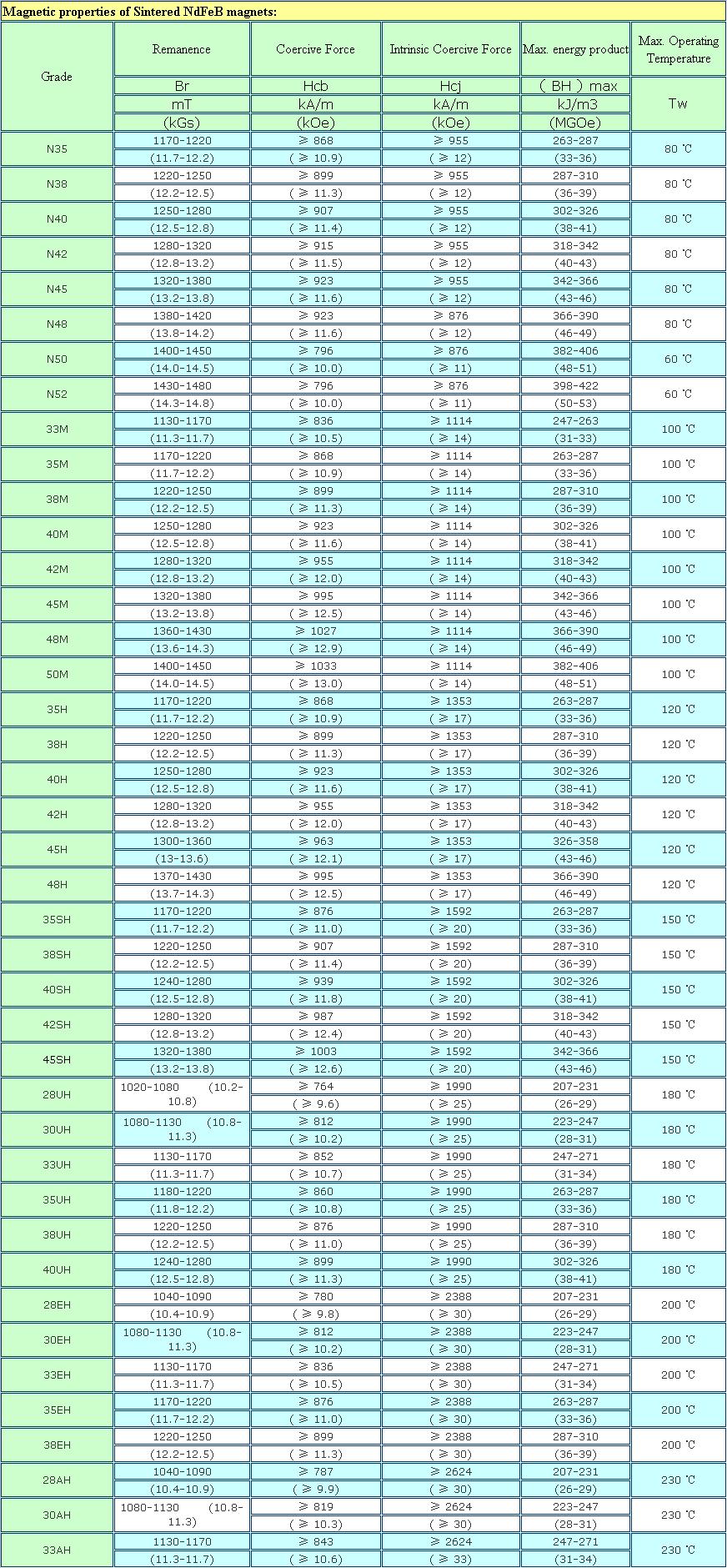

Hey Hugh, thats a very good table. Can I put it on the web site as a reference thingy doodad?

yeh its a good thingy doodad

Thanks mate. I'll stick on the web site this weekend.
