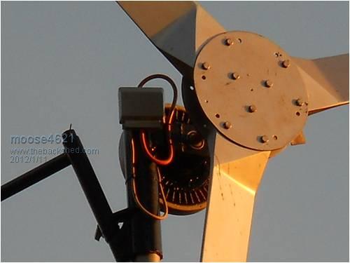

Newbie here. Been lurking for some time now, on and off. I started building a F&P based wind turbine some five years ago and have just this week finally got it flying.
I know it's still not installed as well as it could be as it is currently on the top of an 8 metre octagonal steel light light pole found in many suburban streets but it needs to be twice that height for this location. I have an 8 metre length of 4" water pipe ear marked for the extension.
I carved a set of blades from laminated plywood and then covered in carbon and glass epoxy composite. At 1200mm each I have a 2.4m dia three blader.

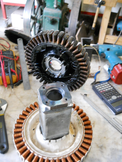

The stator is a 60 series rewired for 48volt, (I forget the arrangement as it was done a few years ago but I have the details in the workshop somewhere. It seems to cut in at around 150 RPM or so. The rectifier is three 35 amp 400v bridge rectifiers.
I'm still in testing mode at the moment and have them connected to a surplus set of 850 amp/hr 48 volt gel cells without a controller and am keeping a close eye on the voltage. As you would expect, nothing is going to happen too quickly with this gennie, especially since I have only measured 100watt max so far!
My main system is a solar array connected to a Plasmatronic PL60 controller which can accomodate a wind gennie with up to 30amp dump load directly. (without external relay). The batteries are 1350a/h wet cells at 48volt. Once the wind gennie proves itself, it will be spliced into this system.
I know I have at least a couple of problems.
1. Even though I decogged by twisting the poles, and later by rounding the poles, it still has significant cogging properties which prevent it from starting at lower wind speeds but above cut in speed. (hope that makes sense).
2. I haven't done the math yet but the gennie is currently sending wild ac down to the rectifier about 80m away via 15 amp extension leads. I'm sure this is causing some loss but I was reluctant to spend the dollars on cable and trenching through rock until I was confident that it would be worth it.

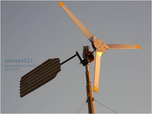

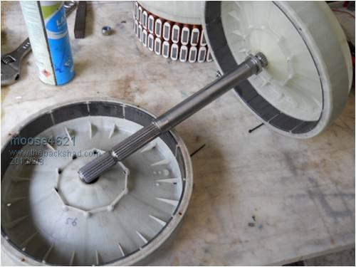

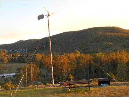

Mean while, I took a couple of shot this evening to decorate this post with as I kow how much I like to see pickies.
The size of the tail is another concern of mine. It was sized according to Hugh Piggot's book but I see most of you guy's have much smaller tails.

Nice looking set of blades you have there! Good work. But your tower is leaning to the left a bit
You can go smaller in the tail, but dont get any closer. The longer the tail boom, the better, it has better leverage and holds the turbine into the wind better.

As for the leaning tower, it was late evening, ie, after rum o'clock and everything seems to lean by then.

Am I looking at your photo right? There seems to be a lot of unsupported shaft behind the hub. May be something to look at upgrading when you decog the rotor.
cheers yahoo

we've had a bit of wind now and I have to say I'm dissapointed. The best I could get out of it is 3.3 amps @ 53 volts and I saw the blades over run the alternator once. The furling seems to take place at the right wind speed but for some reason it oversped at one point but I was too far way to see if the tail was furled. I sure heard the blades though. No damage done though.
Overall performance is well under expectation and if that's all I can get, then it's not worth pursuing.
Maybe I was expecting too much of the F&P or maybe I've got modifications to make but I have regularly read claims of 400 - 700 watts out of these things but my mill will never produce that in it's current form.

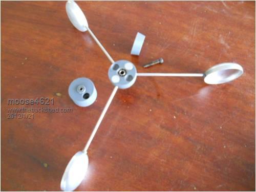

You need some way to measure wind speed, so you can tell if any changes you make are for the better or not. What about building a anemometer? Also, time to look around for a 80 series stator, the 60 series are OK, but the 80 series is much better.

I wasn't aware of the different stators when I got this one off fleabay and of course I got the worst one.
