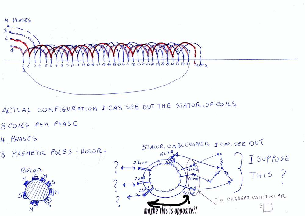

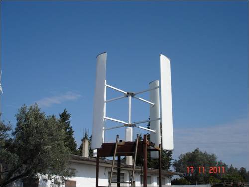

Hi some one know this wiring metod called fractional slot ???
im from italy i bought from china an vawt 1 kw turbine 48 volt
now after more test it dosen't produce power under hight wind
all is ok batteries controllers and cables
when the rotor spinn and arrive at cut in speed about 48 volt
look like backed and dont produce any amperage only voltage throu2012-01-23_175134_diagrham__real_061.rar 2012-01-23_175158_DSC03315.rar 2012-01-23_175221_DSC03359.rar 2012-01-23_175249_DSC03376.rar the phases

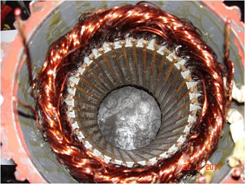

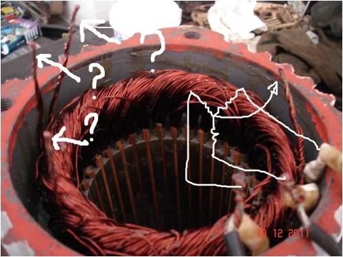

I disassamble the alternator inside and find 8 poles and 33 slot ??
the connection is three phases but i found other unknow three other connection
now i think the operator who wired the stator maybe wrong some position
the factory says the rotor is wired as fractional slot
some know the fractional slot how it works??

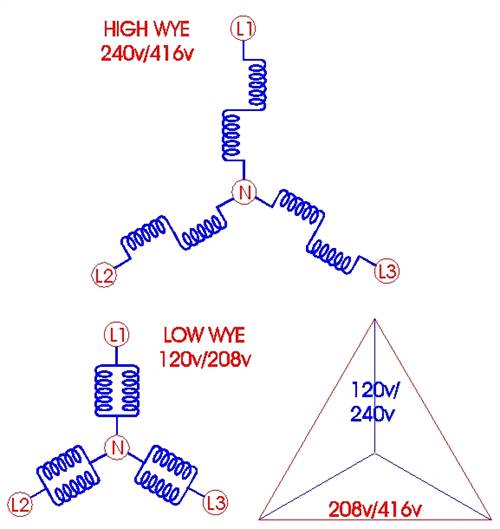

Hello on the wireing I thing it was build for a 6 phase unit . Then was made into a VAWT.
I would bring all six down to try to work with you must Ohm out all 6 wire ends to see if the are all open ended if so it was to let you do a star or delta wiring setup??
If it was like the pic it had 12 wire ends and 6 are grouped to make 2 star phases
you could play with just 1 phase at a time for some power testing.
I would pull the motor and install in a lathe for a few bench tests to come up with a power curve.
I do not think you will not see much power from it China realy over rates this kind of thing.

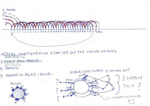

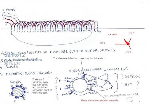

this is the actual diagram some know this particular " fractioned slot "???
the coil are spaced from 5 slots !!

The term used fractioned slots means I think for that the magnets are not lined up to the stator at a unifed degree like magnet 1 is at 0 degree magnet 2 is at 22 degree magnet 3 is at 27 degree and so on . So to lower cogging the winding have no part to the fractioned slot.

thanks bob the mag trhu the rotor are perfect equal distance they are at 45°

I cant see clearly from the photo, it looks like there are two coils per slot.
If that is right that would make it a "constant fractional pitch odd slot 8 pole 3 phase hookup"
The six wires together has me confused, if they were not there, I would say it is wired delta.

the wiring of the coil i suppose is with two line of coopper !

fractional pitch means the degrees of angle two sides of a single coil is smaller than the degrees of angle that two poles of the rotor make.
poles 360 degrees / 8 poles = 45 degrees
coils 4 slots apart 43.5 degrees
the odd number of slots is something to do with reducing harmonics in motors, it could reduce cogging when used as a alternator.
looks to me like there are 11 coils per phase with a constant overlap.

HI MATE YAHOO2 THE COILS ARE EVERY 5 SLOT
I WILL BE CRAZY WITH THIS WIRING

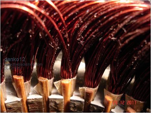

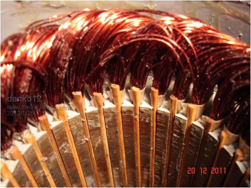

this is the spacers bitwin the coils and slots
the whole slot are 33 !!

Posted: 11:54pm 24 Jan 2012
Could it be possible that they have cut one coil off the end of each phase giving us 30 coils.
10 coils per phase, then wired each phase parallel as 5+5 to lower the output voltage and keep the coils balanced.
That would make the 6 wires the parallel star connection and the 3 pairs the output wires. The 3 single wires would be the original high voltage star output wires.
That would mean there are 3 more cut wire ends hiding somewhere in all that copper, that is the other ends of the coils that have been cut out of the circuit.

hi this is the replay from the factory for the wiring diagrham !!!
