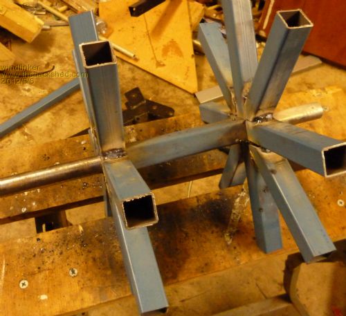

Built part of the rotor. Was thinking about putting 8 60*40*10 ferrite mags on there, with a iron cored coil.
I've got 10 neo mags 30*10, should I get 6 more and use neos or go the ferrite way. I'm thinking off building more and a second one with neos would probable be to much?

Posted: 02:24am 06 Jun 2012
you can weld tinker and that will come in handy later.
you need to mount your magnets on a metal disk that can rotate
at a controllable rpm.
the thickness of that metal disk is directly related to the strength of your magnets.
a good start is 10" saw blades.
when the mags are mounted you can do a test coil.
mind your fingers !
Posted: 04:12am 06 Jun 2012
Attaching the magnets to that square hollow section would loose most of their power.
The above messages mentions a disk, just in case you are perplexed why so consider the magnetic flux lines behaving in steel like electric current does in copper wire.
You want to aim for the shortest return path for the magnetic flux (least resistance), it *has* to flow from #1 magnet's pole N face to the #2 magnet's S pole and then back from the #2 N pole to the #1 S pole, completing the circuit. This should be the shortest path possible with plenty of iron to conduct the flux.
Iron cored coils can cause severe cogging unless you take suitable precautions - there are messages on this subject on this forum.
Build the coils as thin as practical to limit the flux path through them, especially important if you use air cores & neo magnets.
If it was me I'd consider your nice welding as a practice job, do some more reading on axial flux alternator design - plenty of ideas have been posted here so why re- invent the wheel?

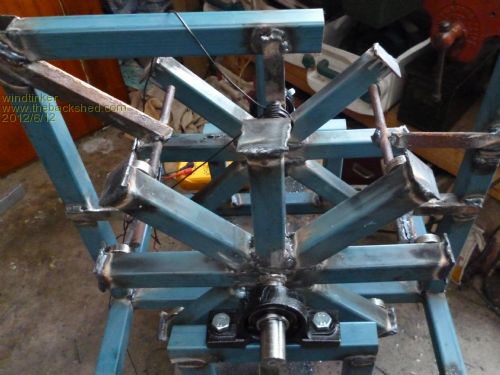

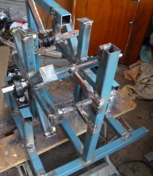

Done abit more of the build. I've got a test coil on there 50 turns, spinning it by hand gives 0.1 volt with one set of neos. Going to do some more test, i'm aiming for 1.5 volt, spinning at 10rev/sec(120volts).
I see what people mean about the clogging, it takes abit of force to start it spinning plus gearing.
@electrondady1,Tinker I haven't added the steel disk behind because I would have to done what I did and cut a hole at the top, but now thinking about getting a skill saw blade and testing the improvement. Thanks
Posted: 10:32pm 11 Jun 2012
OK I can see how this is going to work now.
I think the results are going to be dissapointing. There's a couple of things that are going to kill the performance. First up, your going to have a lot of "cogging", where the magents and poles try to line up and make it hard to spin the thing from a stand still. Secondly, it looks like your using solid steel rods for your core centers. The problem with solid steel cores is they suffer from eddy currents, and dont like to change flux direction. What this means is a lot of the magnets flux is wasted, and is why motors/generators use laminated cores instead of solid cores.
I would put this down to a learning exercise. By all means finish it, but dont invest too much time and money into it. If you use your same magnets and build a tried and tested design like the standard axial flux alternator, then you could expect many times the output power that could be achieved with this build your working on now. Its all part of the learning process, been there, done that.

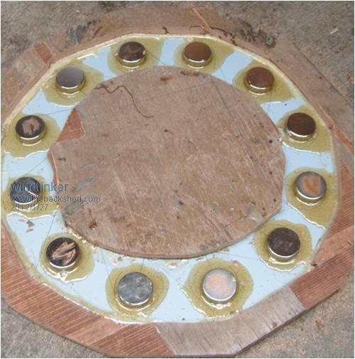

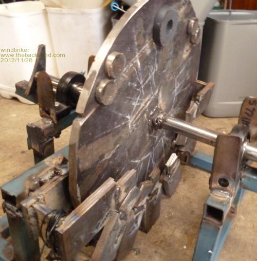

Posted: 07:30am 28 Nov 2012
Hi flogging a dead thread, but this was the final prototype design with 12 mags 100*20*8mm 180turns per coil it should get upto about 12volt by turning by hand.
