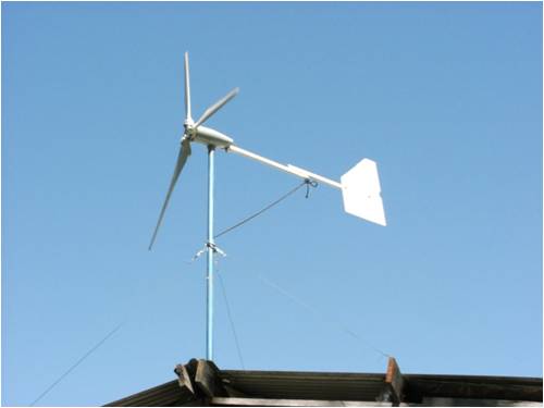

Have two OEM`s with sliprings, also an old(5 years service) 200w mill no sliprings just untangle at base of tower now and again, no drama really. If you search the 4M you`ll find Bob uses a bungee cord.

Posted: 11:45pm 03 Feb 2012
Hi Grandpa
A picture of my old mill that Vic mentions the bungee allows 2 turns in each direction until it winds up and springs back to a neutral point.
The bungee has been on there for 3 years now and still ok, it's marine rigging bungee so it is UV protected.

  VK4AYQ said   Hi Grandpa
All the best
Bob
Excellent idea Bob.
So, I will scrap my idea to use a motor to reset it the mill, (Mechanical, usually is Fool proof), Plus you can also see it working.

I've used a "stop chain". About one every week or 2 if the mill would quit turning in decent wind, I'd go out with a long pole and turn the tail around and unrap the chain and then it would start right up. I'd usually set it to 2 or 2 1/2 turns before it would stop.
I often thought about an "elastic chain". Bungee cord sounds good. Thanks Bob.

Is that the bungee an elastic material?
I thought of using a old cycle Unused tube in thin format, would'nt that help?
