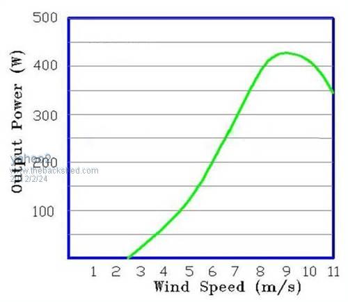

Posted: 06:38am 24 Feb 2012
The blades in this photo are some of the best I have seen on a micro turbine. This is a SWEA but the chinese knockoff is almost as good. Somehow the rotor self limits its rpm's in strong winds without making much noise at all. As you can see from the power curve although it is rated at 300 watts in clean flowing air it can produce a lot more given the right conditions. The one I work on is in a particularly windy spot and regularly hits the 40 amp limit on the controller in cool weather, that is 500+ watts.
From my experience the graph is a bit optimistic at lower wind speeds and conservative at the upper end, I have not seen that dip in power at 10 m/s it flattens out but keeps climbing.

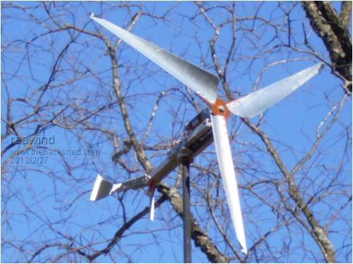

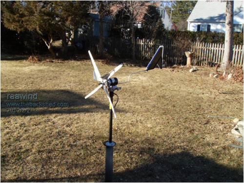

we had a great 3 days of wind up her this weeken sat been the best 25 t0 40 mph winds you would think i would get some good #'s but no nothing over 20 volts, my batts should be fully charged but there not! . I thing your right i need to do some testing- check wiring, etc. i've included a pic of my old and new bird - old bird is in air Thanks raawind.
