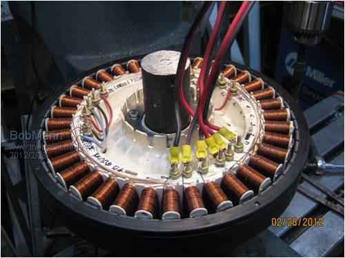

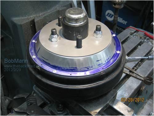

Hello I had been asked by one off my buyers to build a low cost Smart Drive for a Short
VAWT they are bringing to market.
Here are some tests with it a 60 stock stator and using the Smart Controller right in to a solar brand Grid tie
I just did some testing on the Low cost Smart Drive it went well. This one is using the 5 lug hub same axle and that stator is still stock just set up to swap out coil compensation. I do have a 4 lug hub setup but the cost saving is like only $ 17 and I have had some bearings fail over time on the small hub.
It has no cogging, light weight, works very good. Noiseless
I started off in a Delta wiring and ran it right in to the Grid tie it was a 600 watt 50 volt sun unit. All Watt reading were into the grid the grid tie uses about 7 watts to run. Some will say the Watts are down but we are feeding a grid tie a lot deviant than loading a low battery bank.

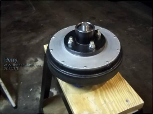

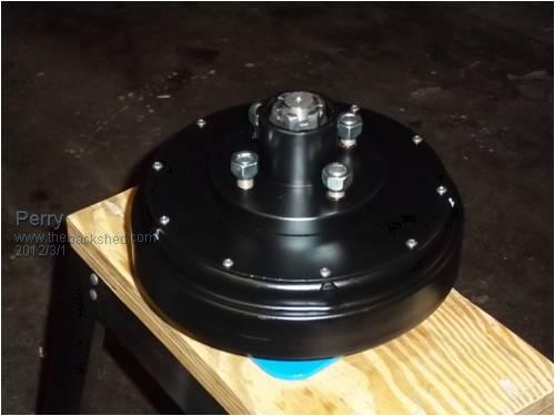

Wait a minute now Bob, that looks suspiciously like the Perry Smart Drive! Are you going to rename it? I'm just breaking your stones a little bit and joking. I think you are more in danger from your wife when she keeps finding her pie tins missing. Dropping the weight of the brake drum does help doesn't it.
I think your numbers don't look too bad at all and good luck with your project. Your attention span does seem much greater than mine. Glad to see you are making progress. I need to get me one of those controllers.
Perry
Here's a link to my build thread if others are interested.
http://www.vawts.net/t44913078/low-buck-smart-drive/
