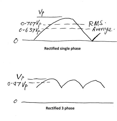

Posted: 02:30am 03 Mar 2012
  larny said
I don't know what the average of a rectified 3 phase signal is & really don't feel like doing the maths.
Len
Average and RMS will be so close together it does not matter.
Both will be about 3% less than the absolute peak of the ac voltage.

Posted: 03:11am 03 Mar 2012
You are right.
Rectified single phase:
RMS is 0.7071 times peak.
Average is 0.637 times peak.
Rectified three phase:
RMS and average are very close to being the same at around 0.97 times peak.
larny
Joined: 31/10/2011
Posts: 349
Posted: 04:54am 03 Mar 2012
A picture is worth a 1000 words. See below.
Len

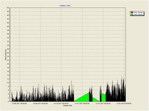

It is currently wired 2 x 7C.
What wiring configuration would members recommend for my wind pattern?
I am deciding between a VWAT or a HWAT.
I have a 200W VWAT at the moment, it doesn't dance around in the wind giving indication the wind isn't very turbulent, the reason for a HWAT is purely for a learning curve.
EDIT: The wind speed on the vertical axis is in m/s (metres per second).Edited by wallablack 2012-03-05
